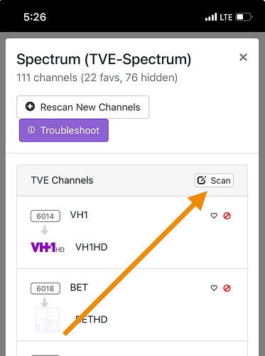

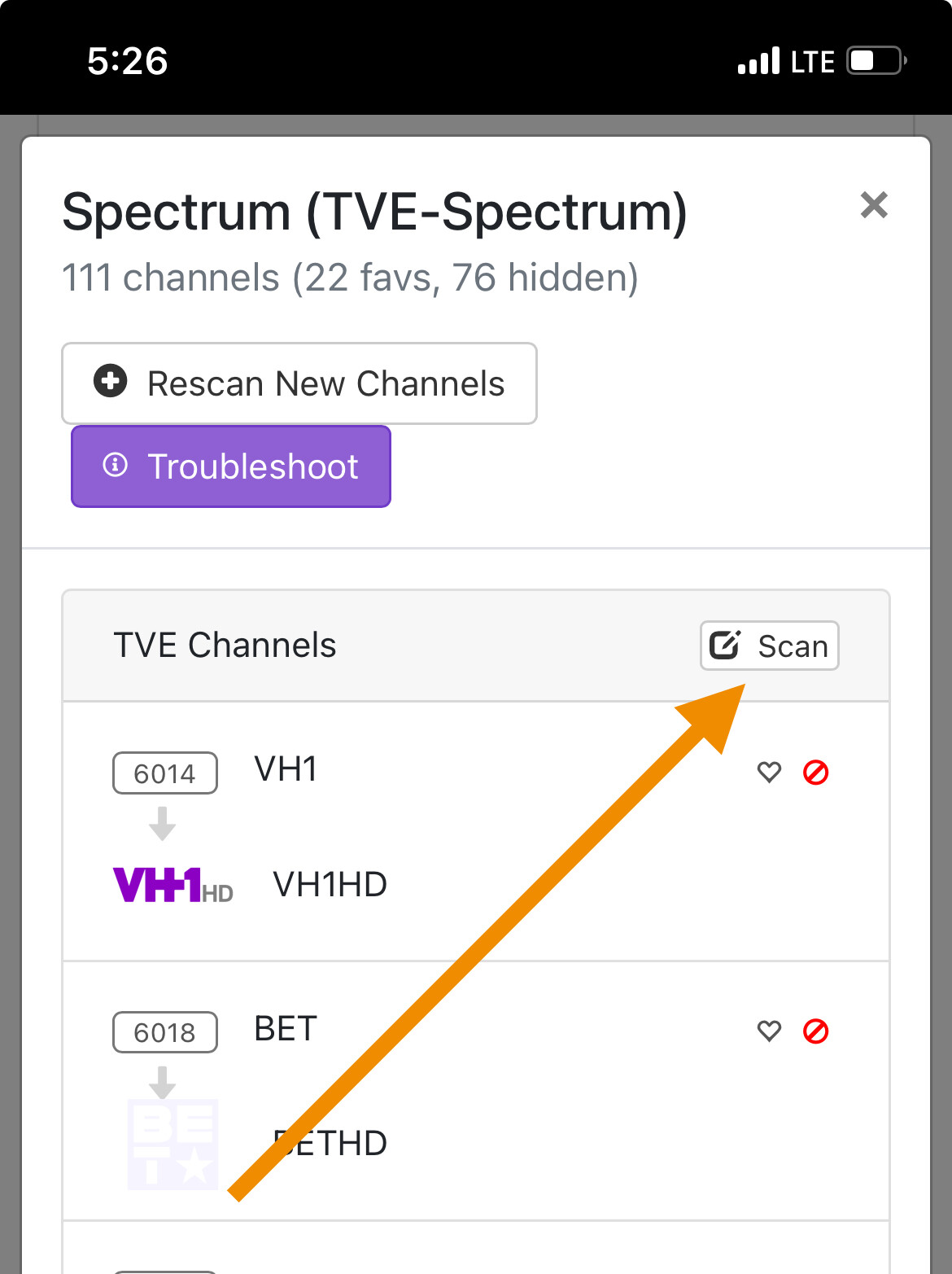

Under your source choose manage drop down > manage lineup > scan. Scroll to channel 6140 and scan.
