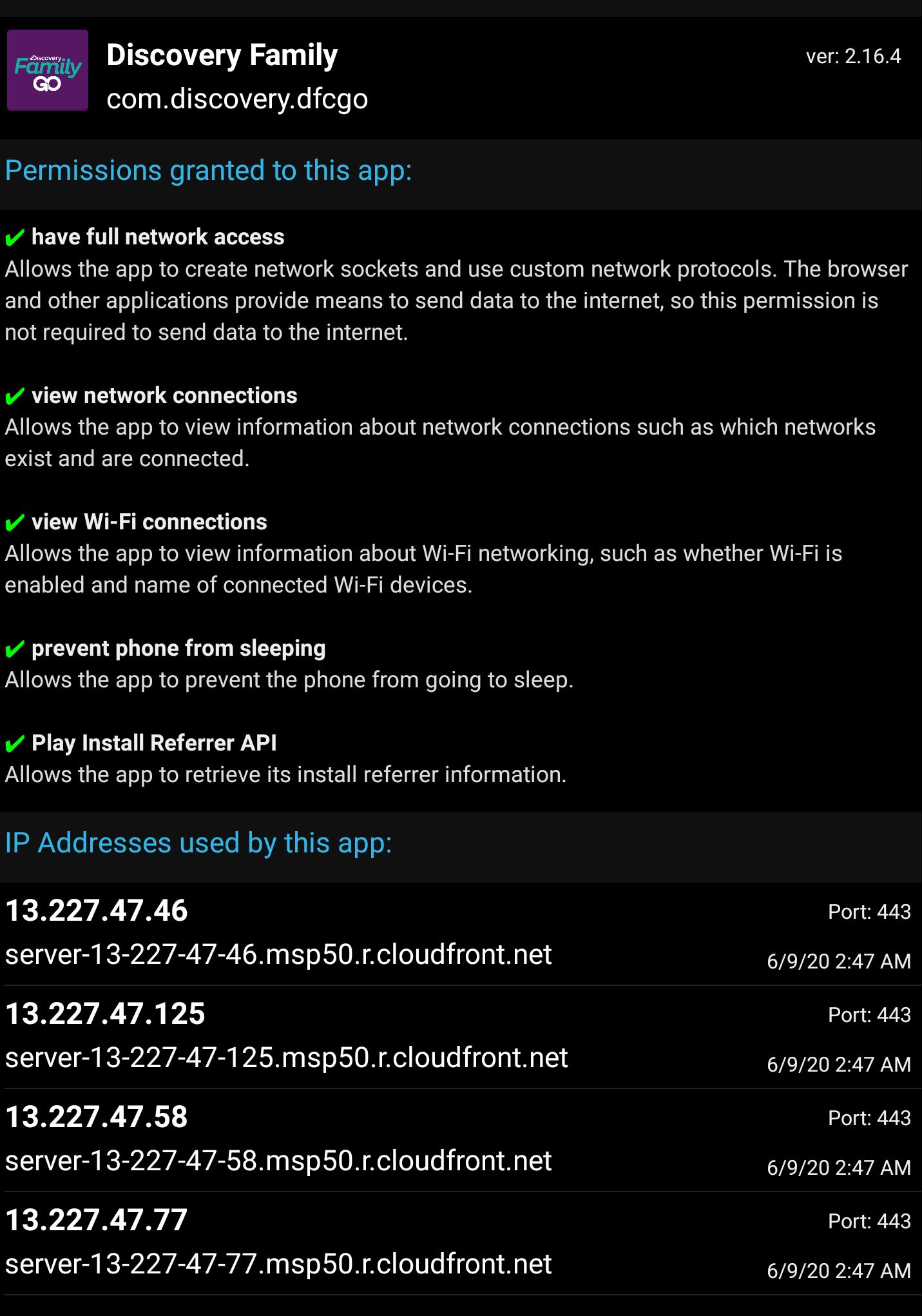

I found a app that logs connections of apps. there is 4 ip address and what it resolves to listed, after logging in with Philo creds and launching live tv stream.
not sure if this is usefull at all. or if there is some other app that can detect far more connections that this random one i found in the Play store.
I know it is possible to raw capture VOD and live tv stream from the DF go app, as, while back, couple years ago now, someone was doing that to make rips of certain shows and shorts off of there, using ffmpeg on PC. i was shown that u have to break the HTTPS connection at some point, the app then spits a error with the full video stream urls and DRM key?..and put that into ffmpeg and it can pull the data. I even was successful doing it myself once. However, i did not keep that info
