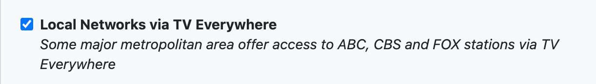

That I believe was pulled in with the "Local Network" option checked under advanced. I still get a couple pulled in from the DISH connection but not all of them I got when YTTV was connected. You need to be connected to the channels UI with HTTPS though. That has always worked for the locals to get pulled in via TVE
