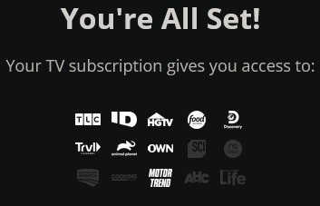

TVE access to Magnolia channel is not available using YTTV as a provider.
https://watch.foodnetwork.com/network/mg
Screenshot Linked To TV Provider
I mentioned this previously that they should remove it from their list Channels Support - TV Everywhere Availability
