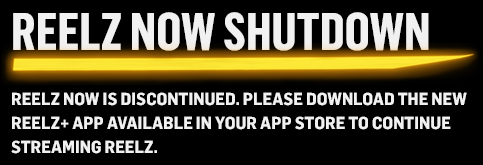

REELZ Now shutdown, only access via REELZ+ now. How do I add the channel via REELZ+?
Thanks,
Although https://www.reelznow.com shutdown
Reelz Now Shutdown

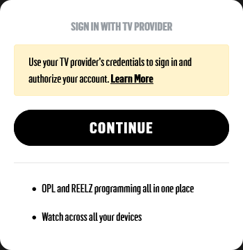

You can still access Reelz by selecting Sign In with TV Provider here
https://reelzplus.com/reelz-en/get-access
Get Access Reelz
