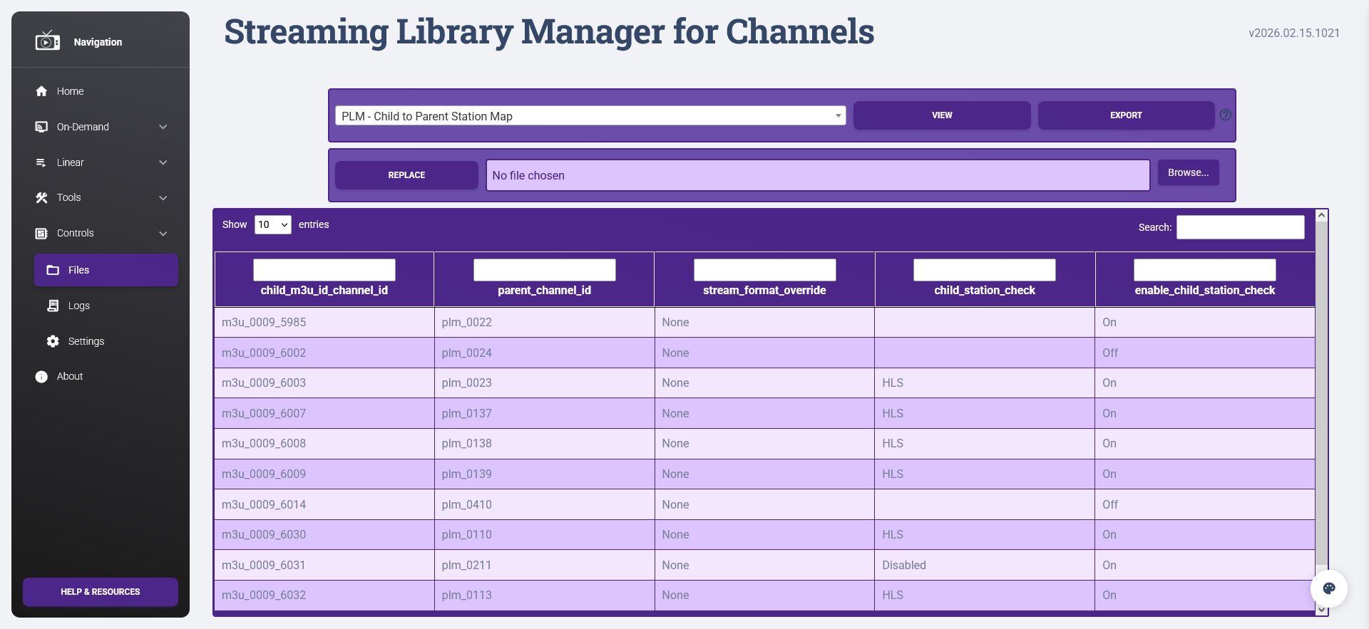

Just to make sure it is clear to everyone, what you are specifically asking about already exists as a report, but you can only use it on the web and you want to export the results of this and use it in something like Excel:
Also, you could technically export any of the base files or link their data and write your own queries, but I know that would be a POA to having the backend handle it.
@mjitkop, you can now export reports as of this version:
Per the notes, this is a first step to other exports of internal data, so let me know if there any issues/suggestions around this.

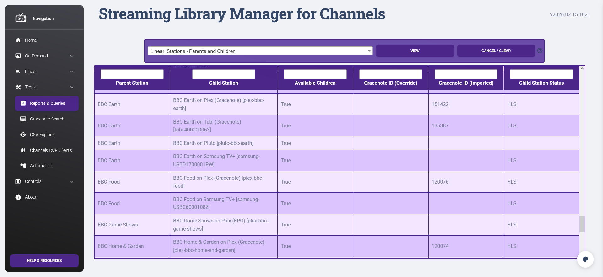

If you run the report Linear: Stations - Parents and Children you can see the assignment order as PLM would do it and if there are any issues with each source:
As you can see, I have practically the exact same situation as you and do not have that issue; the TVE one plays as expected.
