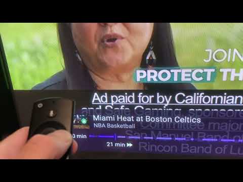

I found problem with scrubbing when remote and using a firestick 4k, if you try to scrub past the buffer, it will jump back and forth and eventually stop moving forward making it impossible to get to where you want to go. For example, trying to scrub 60 minutes into a sports game from the beginning is next to impossible. As long as you wait for the buffer short burst back or front work great. I don't remember it always being like that as I've slowly replaced all my clients with apple TVs which don't have the issue at all.

No problem. I made a video and put it on YouTube here:
I also submitted diagnostics for the video player right after making the video at around 10:46 PM PST.
This is very helpful and not at all what it should be doing. We got the diagnostics and will look into what's going on here.

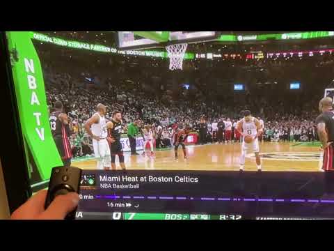

It’s not quite fixed and this is what’s it’s doing now:
I submitted diagnostics right after the video, 5/24/22 9:37 PM PST
Very odd. I’ll look into that one next.
