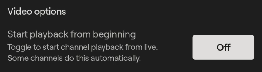

It might have been a setting in the Philo app too that I had to change. It seems like there was a setting that said like start from beginning that has to be disabled. I will check in a little while.
It's a setting in your account on the Philo app. Just turn Start playback from beginning off.
That is strange, I have it set to off (in the roku app and web) but it still plays at the begining of the item. Perhaps I have the wrong deep link? I'm taking the base64 hash from the channel icon and not what is currently playing, is that correct?
