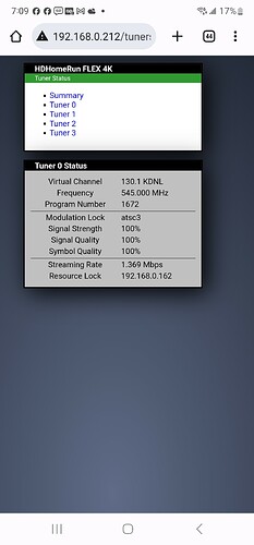

So i am trying the system for a month on my synology NAS and am having this same issue on my Nvidia Shield. Progress bar pops up on bottom with low audio cutout. No disruption in picture. I only see it happening in 130.1 i think. Why is this happening? Would def be a deal breaker for me. Everything else seems ok, but its day 1. Gonna see if this if happening on my Apple tv 4k and other platforms..
Edit, this is happening elsewhere as well. Notice the stream rate looks much lower in comparison to other channels, not sure why. Signal strenth/quality 100%...
