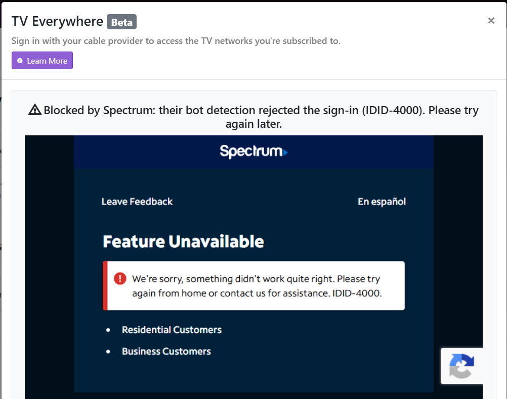

I lost some of my Spectrum channels tonight and they wouldn't reauthorize when I scanned them, so I updated to the latest pre-release which is now 2026.08.30.2236. It still couldn't detect them, so I deleted and added the source again. Now I can't get any Spectrum channels. Just like a couple of weeks ago, I am getting the Blocked by Spectrum: their bot detection rejected the sign-in (IDID-4000). Please try again later message.
After too many authorization attempts, Spectrum will block the scans. Normally you can try again the next day. Once you do a scan and get most (some might still throw errors), rather than doing another full scan, just re-scan those individual channels.

It's a safe to assume that all of those all those other websites are going to slowly remove their Cox connection, thus I decided to try to create a new TVE lineup with my migrated Spectrum login. With this new one, I appear to be locked out for the day with 26 expected stations giving me the Blocked by Spectrum: their bot detection rejected the sign-in (IDID-4004). Please try again later., so I guess I'll have to try again tomorrow!

I also have had TV-E authentication failures, starting on Wednesday 09/16 since the Cox to Spectrum. Trying to authenticate results in Auth failed for Cox: Blocked by Spectrum: their bot detection rejected the sign-in (IDID-4000). Please try again later.

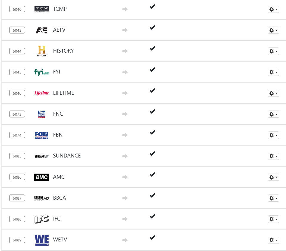

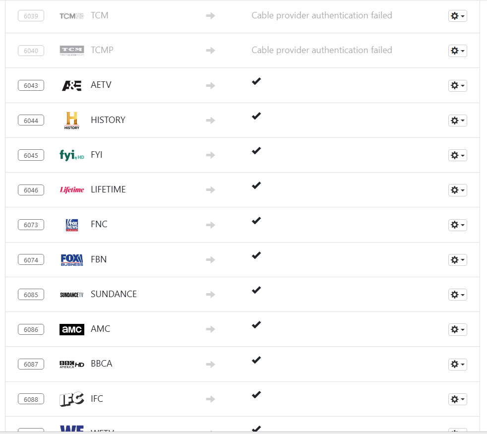

BBCA/IFC/AMC - no issues here, only TCM -see my screenshot above, perhaps the issue is whatever fastchannles is which I really don't care about.

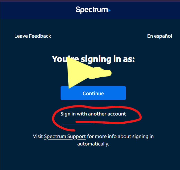

Here is how it auth's without creds, the COX/SPECTRUM account login is prefilled automatically (erased in yellow), If I use the secondary un/pw I created on my account page yesterday and "sign in with another account"- that now works 100% of the time today, was intermittent yesterday.
I think channels is getting stuck at that page.
Also I have never entered my main creds in any browser, app, Apple TV and Google TV devices. Apple TV and GTV will automatically sense im a Spectrum sub and ads Spectrum as my TV provider automatically- no password needed. The programmers at Spectrum really know how to code and make things seamless! -Unlike DOCKER, LEVIS, and OLD NAVY :smiley:

EDIT: I have submitted diagnostics to the Devs, just in case. As an example, I was able to log into TCM's website no problem manually, but the same scan fails when I did it immediately afterwards. The only difference is the machine I'm on, otherwise same network/external IP.

However, I was able to revive my 20 missing channels or so today, by using the "update password" under the source manage page. I did not change the password, I just put the same one back in and saved it. Then the rescan went through
I called up some buddies at Spectrum support (I work in telcomm IT) and they worked some magic, all of the TVE channels that are supposed to work (non drm) work now In Channels DVR, including TCM!! and no need for Levis or Docker or SlowChannels.
