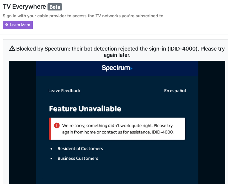

I also have had TV-E authentication failures, starting on Wednesday 09/16 since the Cox to Spectrum. Trying to authenticate results in Auth failed for Cox: Blocked by Spectrum: their bot detection rejected the sign-in (IDID-4000). Please try again later.
I verified I can still open the various channels' pages directly with provider sign-in.
I tried to re-auth the channels individual. That didn't work.
I tried doing a password change, but that didn't work.
I tried removing and re-adding the Source as Spectrum, but that didn't work.
I tried re-adding the Source as Cox, but it won't let me add it back in.
I upgraded to the latest Pre-release, but no change in behavior.
I unfortunately have this same exact behavior as well. Yesterday I had around half of my channels working with one source being my original Cox and another being the new Spectrum one, but as a troubleshooting measure today I removed and attempted to add back both as new source, but now I get immediately denied with the same error (or more specifically IDID-4004).
Hoping that the development team can untangle it and/or that if we try again after some time it will no longer block the login attempt.

  • Discovery — blocked upstream ("Feature Unavailable" IDID-4000)

Here is how it auth's without creds, the COX/SPECTRUM account login is prefilled automatically (erased in yellow), If I use the secondary un/pw I created on my account page yesterday and "sign in with another account"- that now works 100% of the time today, was intermittent yesterday.
I think channels is getting stuck at that page.

Can actually confirm that if you use the Cox-Spectrum selection instead of the Spectrum selection, this should work. It's very strange with each provider website/app what it wants. Hate to make TVE login more complicated for you, but it might be worthwhile to be able to override the provider per source. That might also help people who have multiple TVE sources and each one might get something different.
I'm not sure they can do anything; it seems like Spectrum is doing some blocking upstream that has to be cleared out, and the only cure is time. I basically did the same thing as you because I was able to get some other stuff working and wanted to test it out, and ended up with 20 stations on timeout. Guess I'll have to try to manually scan them again in a day or two!
EDIT: I have submitted diagnostics to the Devs, just in case. As an example, I was able to log into TCM's website no problem manually, but the same scan fails when I did it immediately afterwards. The only difference is the machine I'm on, otherwise same network/external IP.
I tried switching providers from COX to spectrum within channels and it was a big no go with a spectrum splash screen.
However, I was able to revive my 20 missing channels or so today, by using the "update password" under the source manage page. I did not change the password, I just put the same one back in and saved it. Then the rescan went through

4000 is just like the other errors; a timeout, except it seems to be longer than the others.
I was getting this for my Discovery stations for about 3-4 days and it cleared up on its own. I've had it on my Turner Sports stations for about 2 weeks now, but apparently a couple of days ago TNT/TNTP fixed themselves. I did nothing special; just run a check every 24 hours to see if they work or not. I'm thinking this is a Spectrum-to-Provider problem.
