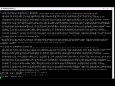

Step-by-Step Guide: Installing Ubuntu Server, Channels DVR, and YTTV TVE
I put together this video to simplify the installation process for Ubuntu Server and Channels DVR.
Many people avoid Linux servers because they think it's too hard to learn or that they need a graphical user interface (GUI). This video proves that’s not the case—Linux servers are approachable with just a bit of guidance.
Another common misconception is that YouTube TV’s TVE (TV Everywhere) doesn’t work with Channels DVR. I’ll show you how to make it work step by step.
Below are the command-line entries you’ll need for each part of the setup:
Disabling SNAP
sudo rm -rf /var/cache/snapd/
sudo rm -rf ~/snap
sudo apt-mark hold snapd
Installing Chrome
wget -q -O - https://dl-ssl.google.com/linux/linux_signing_key.pub | sudo apt-key add -
sudo sh -c 'echo "deb [arch=amd64] http://dl.google.com/linux/chrome/deb/ stable main" >> /etc/apt/sources.list.d/google.list'
sudo apt update
sudo apt install google-chrome-stable
Setting Up Channels DVR
curl -f -s https://getchannels.com/dvr/setup.sh | sh
This video will take you through the process step by step—no prior Linux experience required! Let me know if you have questions or need any help along the way.
(FYI I just posted the video so the resolution is really low until YouTube finishes optimizing it).

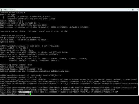

I'm adding a video tutorial that demonstrates how to add an additional hard drive for DVR recordings on an Ubuntu Server.
The video will walk you through:
Preparing and mounting the new hard drive.
Configuring the Channels DVR server to use the new drive for recordings.
Ensuring the setup persists after a reboot.

Just updated post #2 with a tutorial on how to add an additional hard drive to ubuntu server, create a mount point, and configure Channels to use it. enjoy

Suggestion, can you update the tutorial to include drives greater than 2TB? Tried to follow along but it kept capping the limit at 2TB. Currently researching how to do this myself, so hopefully won't need the tutorial, but others may benefit who are not Linux savy enough to figure it out (and I may fit that bill). :wink:
Edit, was able to get it working use the following guide
So, if we have a USB 3.0 SSD, and plug it into the BeeLink, it will not auto-recognize the disk?
If you do it during install i believe it is recognized. Otherwise you can follow the the link @jator posted and that will work for sure
