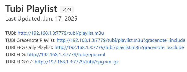

Hi, I just noticed that my Tubi source M3U lost all of it's channels today. Does anyone know if there is a problem with the current docker container? FWIW, the Tubi app and website appear to be working.
v2.01 working here
I was about to say I'm not having this issue, but I checked, and it turns out I am (using v2.01). It looks like things were okay this morning...
