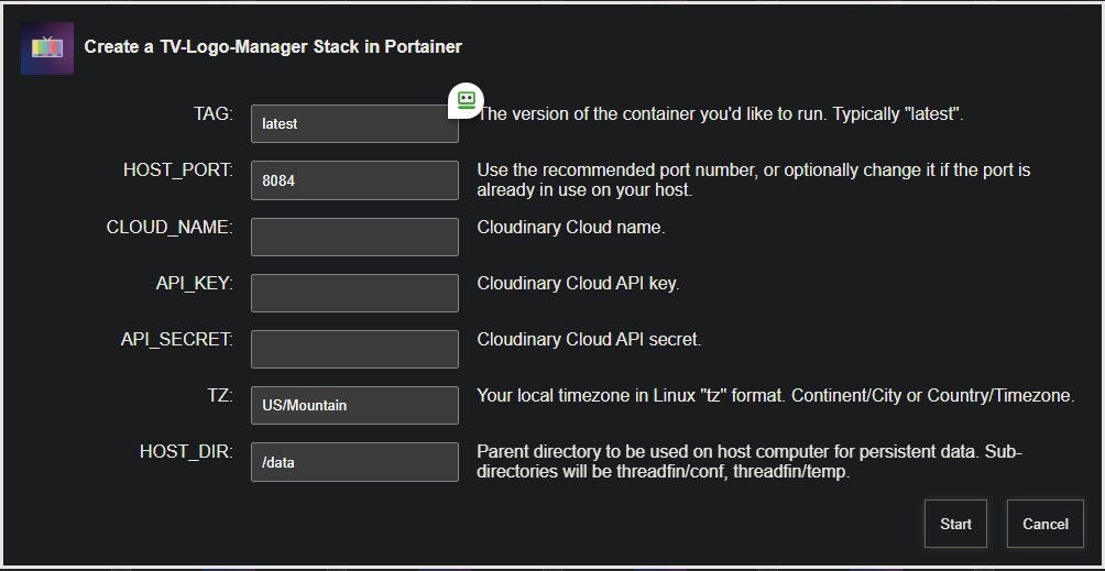

A new bnhf/olivetin:latest (aka bnhf/olivetin:2025.09.13) pushed today with Project One-Click support for this project:
screenshot-htpc6-2025-09-13-16-33-03
As always, projects can be both added and removed through Project One-Click!
