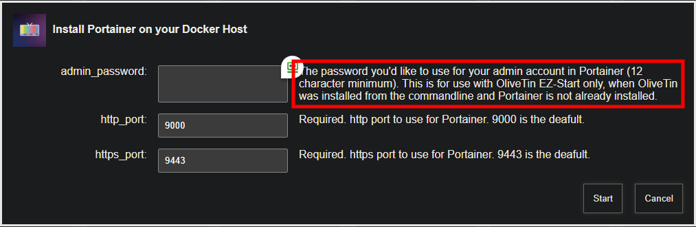

For anyone following along on this issue, the cause appears to have been related to password length. The Portainer default minimum password length is 12 characters, so you want to be sure to conform to that requirement when spinning-up Portainer using OliveTin EZ-Start:
I'll add a check in future versions of OliveTin to confirm a minimum length password is being used.
Added in bnhf/olivetin:latest (aka bnhf/olivetin:2025.07.09)

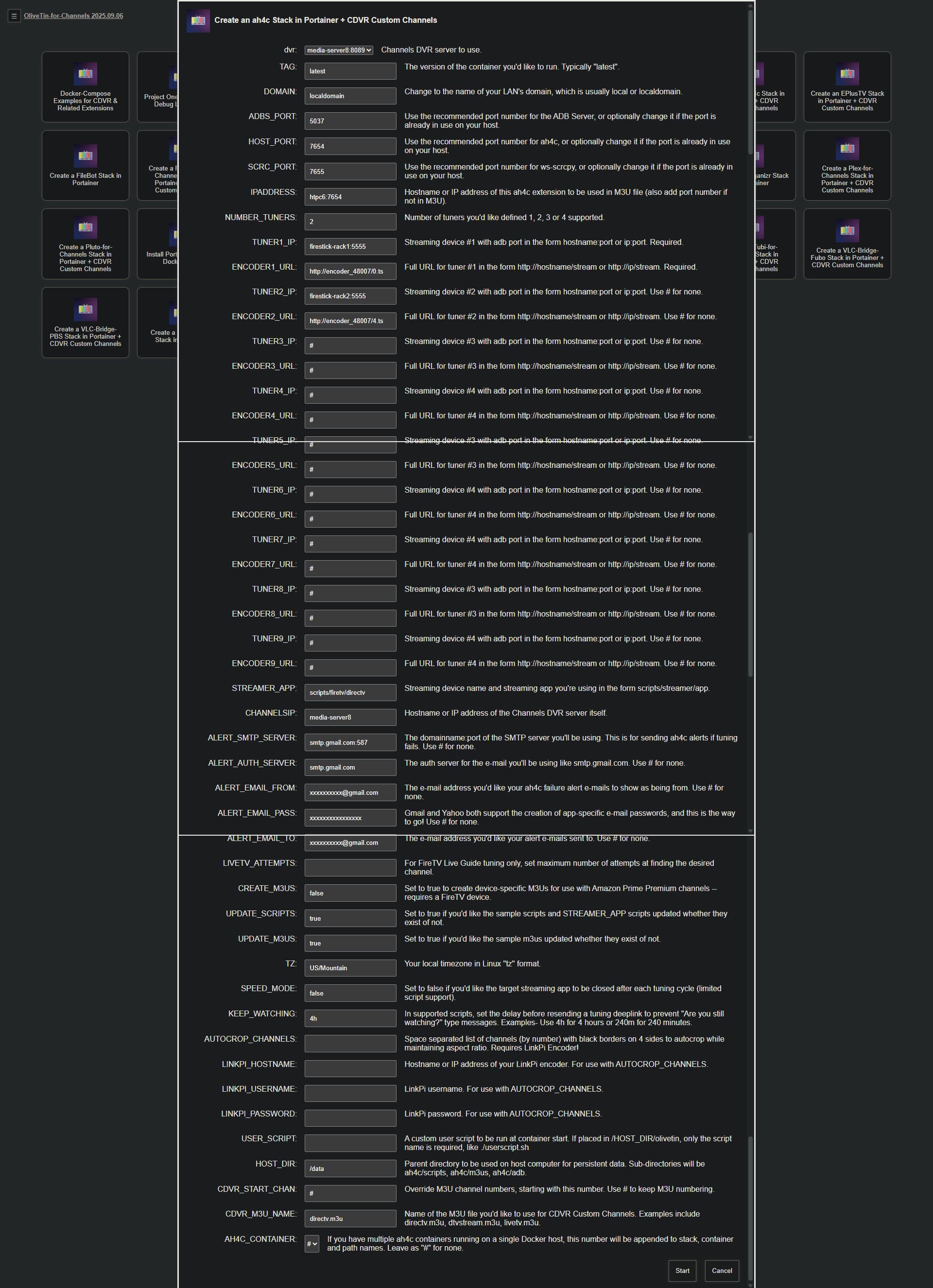

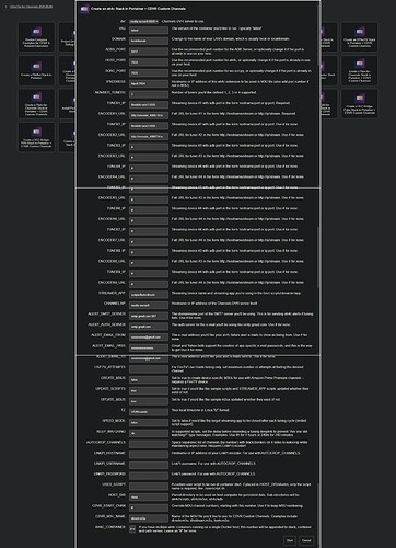

This update includes numerous enhancements to ah4c deployments through Project One-Click. Spinning-up an ah4c stack for DirecTV in particular, should be especially quick-and-easy for any of these devices using the STREAMER_APP and M3U_NAME values listed below:
FireTV, ONN or CCwGTV streaming sticks:
STREAMER_APP=scripts/firetv/dtvstreamdeeplinks
CDVR_M3U_NAME=dtvstreamdeeplinks.m3u
Osprey streaming boxes:
STREAMER_APP=scripts/osprey/dtvosprey
CDVR_M3U_NAME=dtvosprey.m3u
Here's what the Action looks like. Data required for each field is described, but in addition to the couple of values above, you'll need the details (IPs or hostnames and URLs) for your streaming devices and encoders:
With the proper data entered, this Action will spin-up the stack, and add the Custom Channels Source to your CDVR Server. Assuming you've already activated developer options, and USB debugging on your device, installed the DTV app, and logged in -- approving the ADB connection on each device is about all you should need to do, before you can try to tune to one of the channels in your subscribed package!
