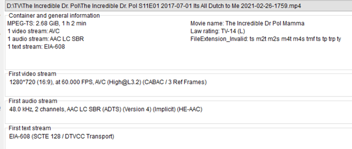

EDIT: Media info does have a line that say invalid file extension..but...if the file still work fine...who cares? though, the next logical question is, would that affect other things. I did rename one of the unaffected TVE files in the same fashion, did not seem to cause any issues.
