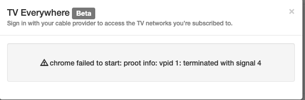

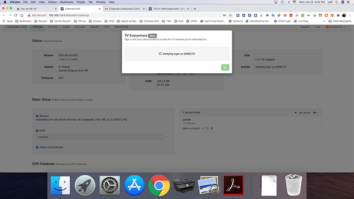

Hey @tmm1. I did as you said, except I didn't see a save button, but I'm assuming the sign in is the same thing. I did click and hold but it eventually went to verifying. At the end I got a similar error to before but now it says 4, not 11. I'll attach screenshots.Screen Shot 2020-06-22 at 8.40.07 PM Screen Shot 2020-06-22 at 8.41.07 PM

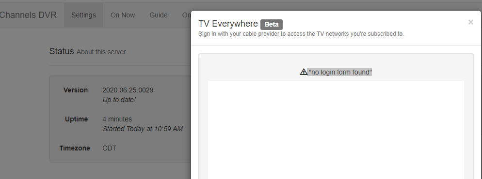

I just installed this on my ReadyNAS that has 4 cores / ARMv7 Processor rev 4 (v7l)
Version 2020.06.25.0029
When I try to add Philo I click confirm on the email. The DVR changes to verifying logon and then says "no login form found"
Could you click Support > Submit Diagnostics
Logs have been submitted as f9a2f296-bef4-4d32-9a56-1777105bd50b
Interesting, thanks. Could you SSH and run this command:
cat /etc/resolv.conf
And paste the output shown here?

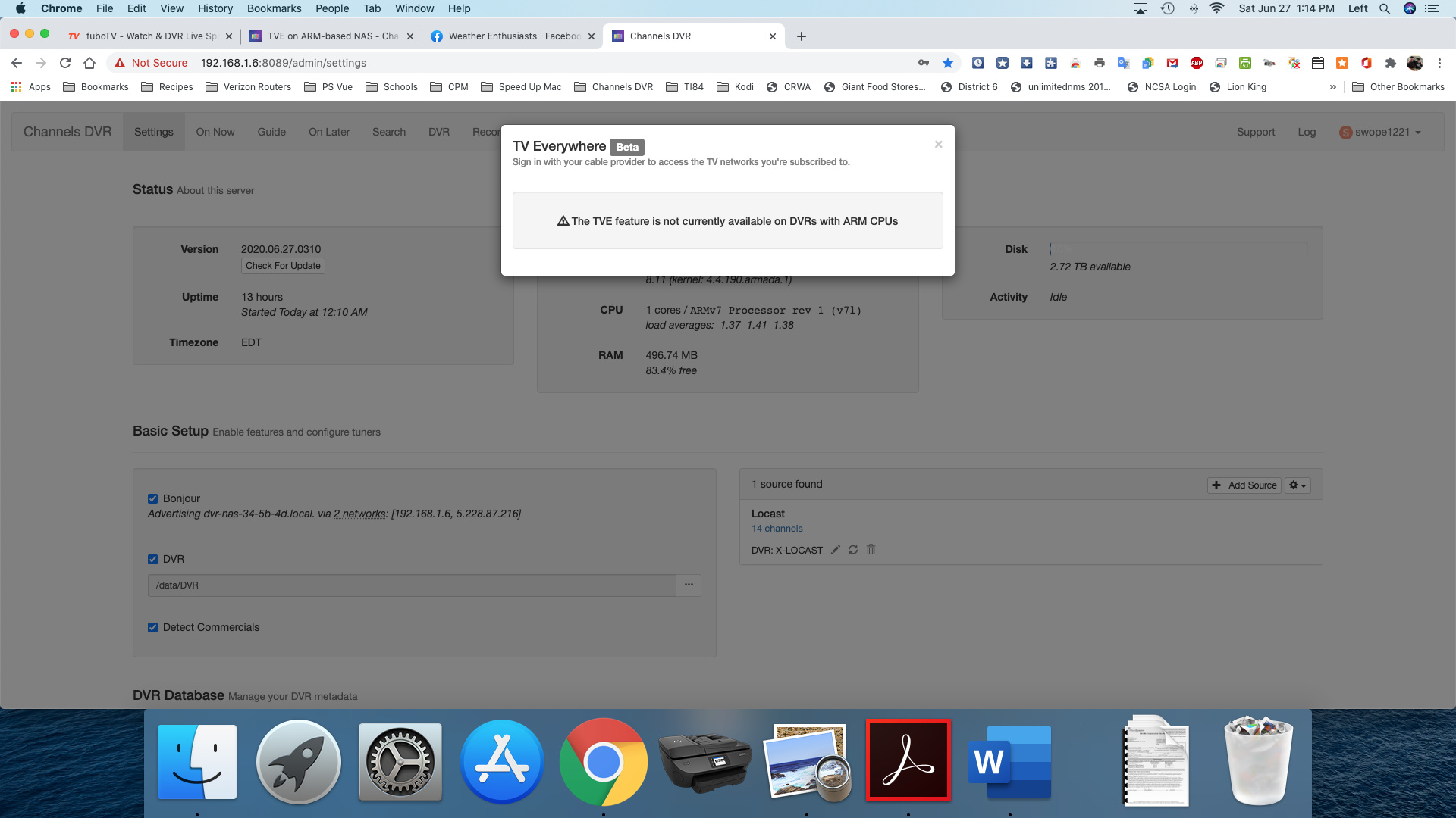

Hi @tmm1. I updated to version 2020.06.27.0310 today and now I get this error message on my Readynas. It went from an error message previously posted in this thread and shared in a pm with you to now back to saying TVE is not supported on NAS with ARM CPU.
We had to roll back to the previous code because of issue and will be revisiting this next week.
Unfortunately it seems if you were seeing "signal 4" then the CPU is too old and we won't be able to make it work. There is a feature called NEON which is available on all newer ARM processors and that's required to be able to make this work.

~# cat /etc/resolv.conf
Generated by Connection Manager
nameserver 192.168.1.1

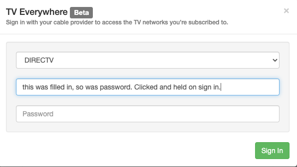

Did you click and hold Sign In as described above?
Correct, I click and hold sign is as described, the window says "Verifying login with...", takes a couple minutes and then returns the message I pasted above.
I have tried what has been discussed above:
  1. Hold Check for Updates and completed update
  2. Add Source > TVE
  3. entered credentials and held "Sign in"
Just gives me the same error TVE no support on ARM based devices.
What am I missing?
