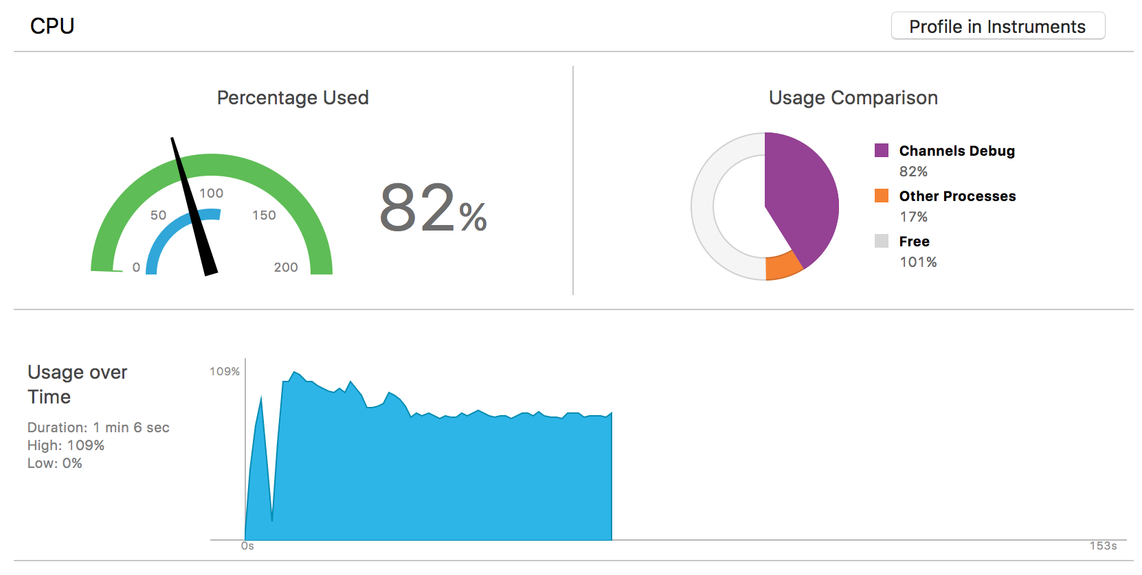

On tvOS 10, Channels requires about 80% CPU to playback high-bitrate mpeg2. This is pretty high, but still leaves enough room for the OS and UI to function. If you’re just watching TV with no UI, tvOS 10 plays back without any frame drop issues. (Still, if you pull down the quick guide on tvOS 10 and swipe left/right quickly you can see the video in the background struggles and drops some frames because there’s not a lot of headroom).
On tvOS 11, for some reason the CPU usage during playback of mpeg2 is 100-110%. This is using the exact same test recording, and the same build of Channels with the exact same code on the same hardware. This means that something within tvOS itself has been changed which is affecting the CPU resources available to our app. With CPU usage so high, there’s barely any headroom on the system and it will periodically fall behind and has to compensate by dropping some frames.
The InstaTV and VLC apps use the exact same mpeg2 software-decoder as Channels, which explains why all three apps are now seeing this issue after upgrading to tvOS 11. This issue also only affects the 2015 Apple TV 4. The Apple TV 4K works just fine on tvOS 11, since it has a much more powerful CPU which can decode high-bitrate mpeg2 without breaking a sweat.

The difference in CPU usage between the two OS versions is astounding. I'm still not sure what they did to cause such a big performance drop.
tvOS 10:
tvOS 11:
