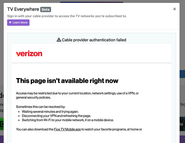

I am having the same problem. Started about one week ago as best I can determine. However I don’t think this is a Channels DVR issue. When I try to link the HGTV app to my Verizon account I see the same page isn’t available response.

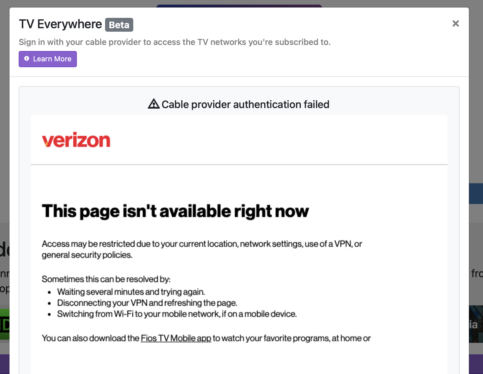

Hi - I'm brand new with Channels, setting things up for the first time. I installed the server on a Mac Mini, and am now trying to add TV Everywhere as a source. We are Verizon Fios subscribers, but I can't get past this "Cable provider authentication failed" error. Any suggestions?
Incidentally, I can sign into tv.verizon.com in the browser and watch video from verizon, so that should at least verify I have access (??)

So I ran diagnostics and submitted - will wait to hear back - though I'm not on the pre-release version. Is there some reason to switch to that and try again?
The pre release has the fix in it
Only if you want the fix now.
Otherwise wait for the next release version (could be months).
Thanks for popping in with your suggestions. However, I just updated to today's build and it still doesn't work unfortunately.
BTW I called Verizon, not helpful. I also tried both Safari and Chrome... no difference.

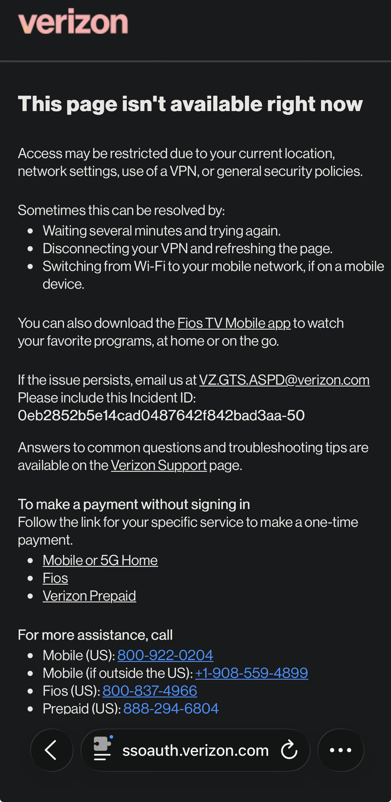

It’s a Verizon problem that’s been happening for weeks. Verizon login won’t work on TVE sites.
Send an email to that address in the error.

How did you get to that page itself? Seems it'd be good for me to submit my own incident ID...
Yes - although a caveat is I think it recognizes my network, that we're Verizon customers. As soon as I hit Verizon amongst the list of providers, I'm in. It does not prompt for username/password.
