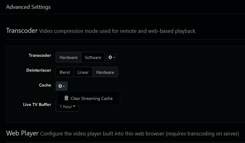

And where did the local cache go?
I know things keep changing and moving, but I don't see it anywhere in Settings to clear it out using v2024.10.17.1732
Wasn't it under Settings > Advanced > Transcoder?
Not in Settings >

This one that I found in one of my other servers.
Clear Streaming Cache.

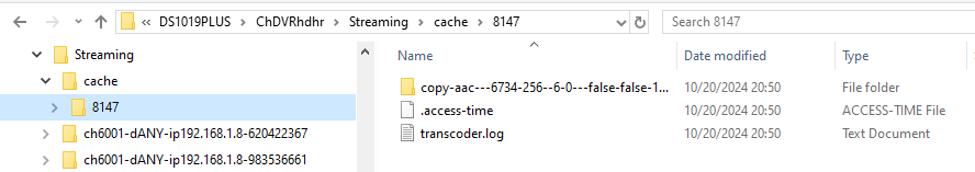

The directories show
The server I was just playing a recording on shows
Where each directory is empty, except for a file named transcoder.log
I was playing FileID 2841
Trying it again, I now see the folder
but there's no Clear Streaming Cache

Where do you see that Cache option ?
Like i said, under Transcoder. just like in your first screen shot.
And... just was going to take screen shots of both my servers, i must be blind or maybe cause i had not had my late morning coffee, but i swear when i first compared the 2 servers an hour ago, the Linux server did not have Cache option. Now it does. :rofl: The only difference is that Linux server has a Hardware option under Deinterlacer.
Oh. Hello!. I was not crazy! I was right the first time, that my Linux server did not have the cache option.
The cache option under Advanced / Transcoder, only appears when there is cache on disk.
I clicked that option and clear cache, and now the option does not show at all.
I play something in the web ui from that server, and it appears again.
What server hardware are you running into this issue on? From one of your screen shots of cache location, appears to be a NAS? Maybe it has something to do with that NAS's OS, some permission issue or something.

Channels is running on a Synology NAS and my directory screenshots I made were from Windows Explorer looking at the NAS directory through an SMB share. Channels runs on and uses the NAS to record, I just sometimes view the NAS directories from my Windows laptop.
