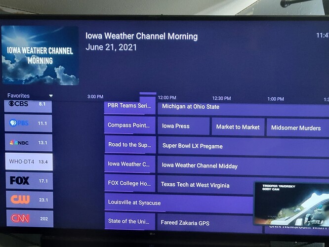

I am getting the crashing as well.
Also, wrap around works if you are at the top of the guide and want to go backwards, but does not work if you are at the bottom of the guide and you want to go down.
Looking into it.
this works fine for me.
speed test crashes everytime

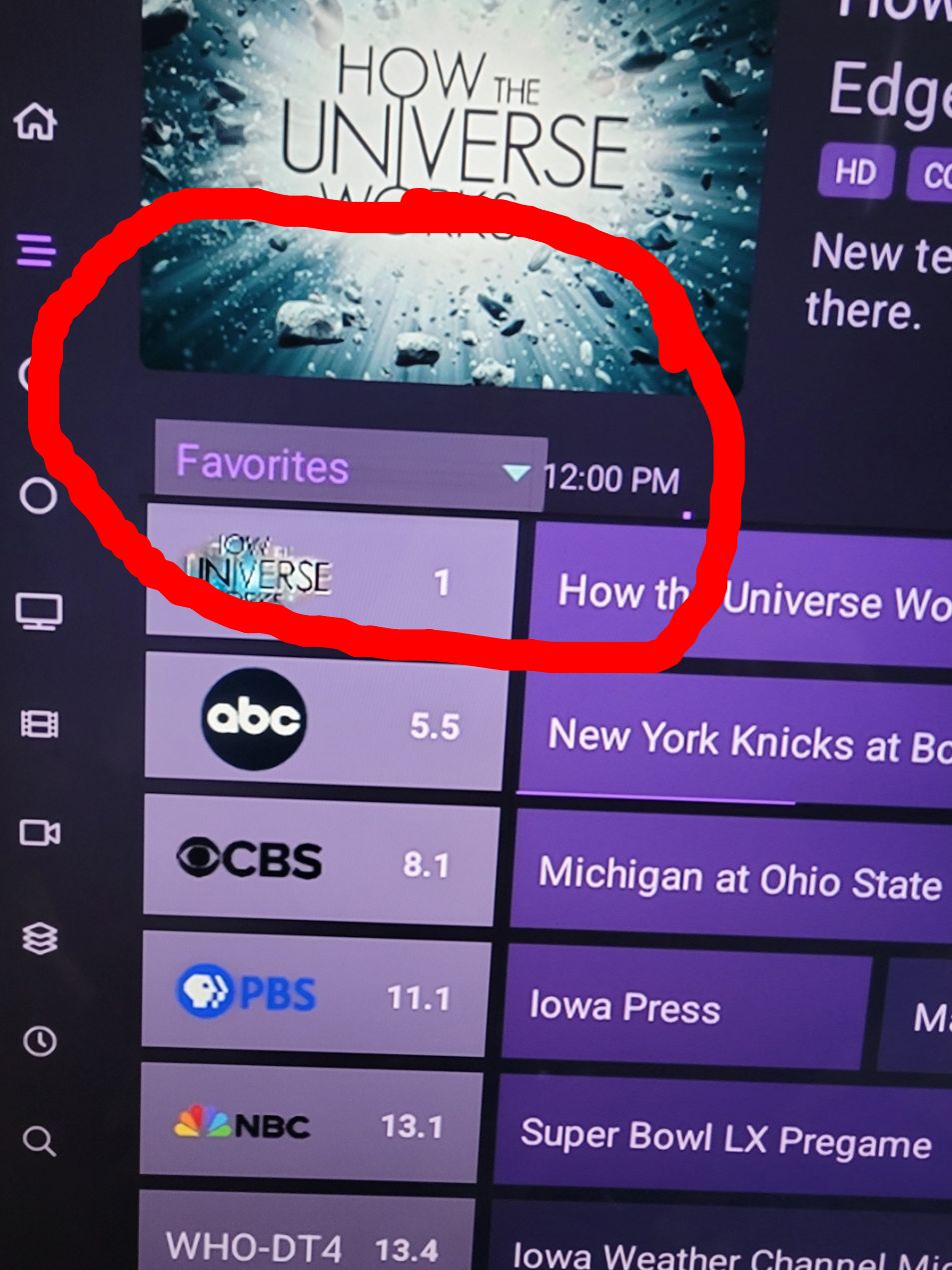

while navigating the guide and trying to reach the sidebar navigation (back button) it first tries to go to the top of the guide. sometimes this glitches out and fails to actually move the guide, but a down arrow will move to the 2nd channel and repaint the guide. other times it will simply crash out.
most of the time it seems to work as it should. although it would be nice if we could simply arrow left to reach the sidebar navigation instead of using the back button.

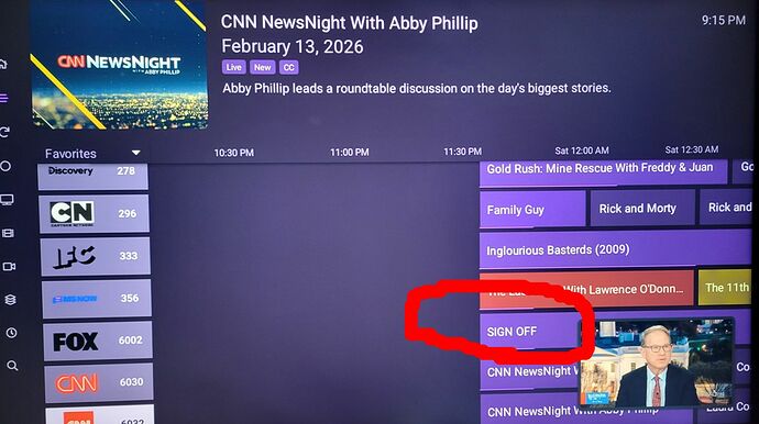

caught it again. it was while navigating around the "SIGN OFF" block for TVE fox. think the picture is the 3rd time I made it happen in a row.
also while trying to get to settings to submit diag, I could not get to the sidebar navigation, and ended up at the streamer4k home screen. I don't think cdvr beta crashed, as it launched as if it never did. (finally used F1 to get to Recordings screen, then sidebar-settings)
seems to only be a problem on the guide, all other screens i've tried (Up Next, Recordings, ect..) all allow access to the sidebar navigation, with a subtle differences.
the screens; TV Shows and Movies (I have no 'videos') require the back button to reach the sidebar if a show or movie is highlighted. other fields on these screens and all the other screens will bring up the sidebar with a simple navigation left.
I can understand the initial logic that may have factored into the programming, however it seems unnecessary to deny access with the left button when the minimized sidebar is visible to the left.

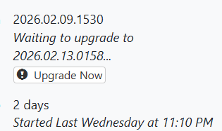

just noticed there was an update today? anway
editl
yes its still happening with sever ver. 2026-02-13 220106
