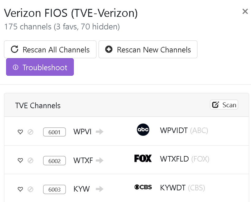

I've enabled TVE for broadcast networks and I now have a 6000 channel for Fox that only lists the sporting events, which is exactly what I want :slight_smile: When I stream the channel during "Sign off", a stream comes up that says something like "this is only for sporting events check back later", which I'd expect.
However, during the actual events, I receive an error that the stream cannot be accessed. It's only happened in the overnights. Next time it happens, I'll grab the error and submit logs.
Fox is channel 6002.

Running latest pre release. Getting a 404 error. Affiliate is WVUE.
Mine was working yesterday, today I'm also getting a 404. Fickle Fox.
Are you seeing the same thing I am when authenticating on their website?
Yes. And just like you, it's only 6002 / Fox network. No issues with FS1/FS2.
