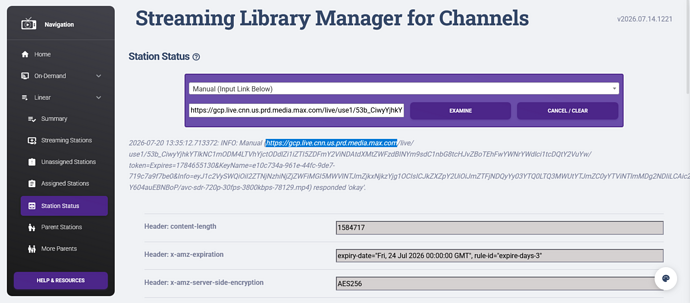

Looks like CNN may have joined CNNI and HLN in modifying its delivery method. FWIW, works on the web and all the apps on all the system types. Also, if you take the stream directly from the website, it validates just fine:
Like the other properties, Channels is currently not able to take into account these changes and seems to be failing:
2026/07/20 13:24:47.448430 [ERR] Failed to start stream for ch6030: TVE: Stream Not Available
2026/07/20 13:24:47.457466 [HLS] Couldn't generate master playlist for ch6030-dTVE-Cox-ip172.22.0.1: TVE: Stream Not Available
2026/07/20 13:24:47.457742 [HLS] Stopping transcoder session ch6030-dTVE-Cox-ip172.22.0.1 (out=0s finished=false first_seq=0 last_seq=-1)
The corporate structure of TWD is pretty messed up and they don't share technology suites among the whole company. Even TBS/TNT/truTV run separately, although share a little bit, while TCM is stand-alone. CNN is the same, as are the Discovery stations.

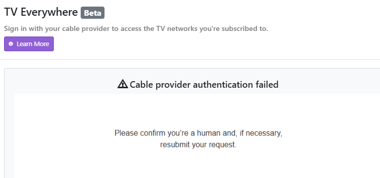

CNN is back on TVE. I did the rescan/authorize a second time and it worked !!!
If only it carried MS NOW !!!
EDIT it's back and authorized but it wont pla yor record in channels what gives?
That's the same behavior that I've seen all day. It authenticates fine, but you can't actually watch it.
