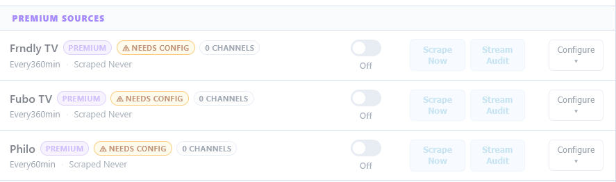

I am adding support for premium DirecTV and Sling to FastChannels for next version and they both have CNN. It will rely on Prismcast DRM bridge, but a little simpler to use if you not into HDMI encoders and Chrome Capture.

PrismCast is discussed in great detail at the same link. The only thing not discussed are the premium sources from FastChannels that can integrate either directly or through the PrismCast bridge inside FastChannels:
