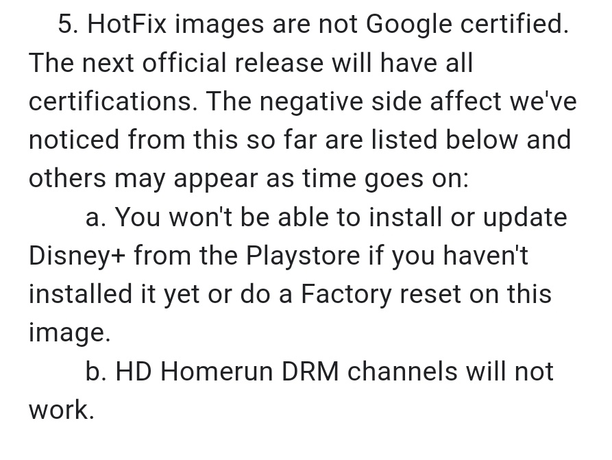

Is anyone running the hotfix and still having these issues?

If these are the only issues with the hot fix, I'll give it a shot, having the same issue.
Does that mean TVE will break though?
No effect on TVE
So I understand correctly: the hot fix should prevent the pre-release dvr server to time out after a while or during recording?
