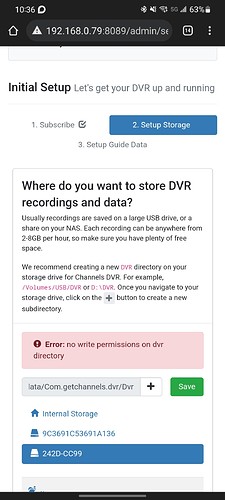

You have a leading . that shouldn't be there for the package name: com.getchannels.dvr, not .com.getchannels.dvr.
Likely it also needs to be com not Com

Typically for the apps to have full access to the drive the data needs to be in the /nvidia_shield like storage/242d-cc99/nvidia_shield/…. Try that file path
That doesn’t work. It’s the entire external drive path that is denied. Only the internal and adopted storage is being allowed read/write access.
It’s something Nvidia or Channels DVR devs has to fix, because it is even affecting file managers. Those, even with the correct user-facing permissions, see no files in any external device directory without additional access given. FX, for example, has to mount my external drive separately (which involves invoking the native Files app to select the path) to even see the files on the external drive.
It might be because of how Android handles apps' access to storage in 11, such as defaulting to using scoped storage.
