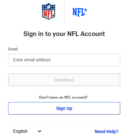

How did you authenticate with TVE?
It takes me to a page NFL Account Activate Account asking for NFL.com credentials
brave_screenshot_id.nfl.com
Pretty sure it is a two-step process. I think this is what I encountered.
Once you add your NFL.com credentials you will see the option to authenticate with TV provider on the EPlus webpage. NFL.com account can be a free one; NFL+ not required?
Thanks, that explains it. I don't have an NFL.com account.
That is correct. You need to sign in with an NFL account first but no NFL subscription is required. After you complete that sign in and the NFL provider is enabled in EPlusTV, you will see a few additional authentication options under NFL in the EPlusTV web interface, where you can sign in with your TV or streaming provider.

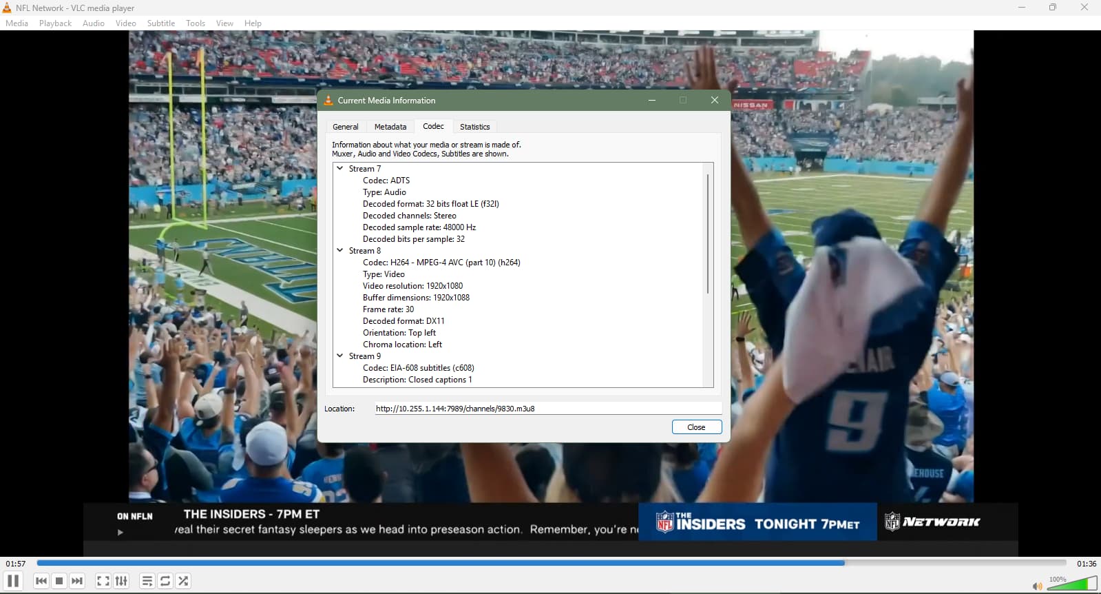

@tonywagner and @TJN basically covered it, but here's some additional directions for getting started with NFL:
The original post above is a bit dated because it references the old Environment Variables, but the approach is otherwise the same. In EPlusTV, authenticate with the NFL.com login first, then check the box for your provider (i.e., TVE), and after that check off NFL Network (and/or RedZone if you have access). In the end, you'll look something like this:
