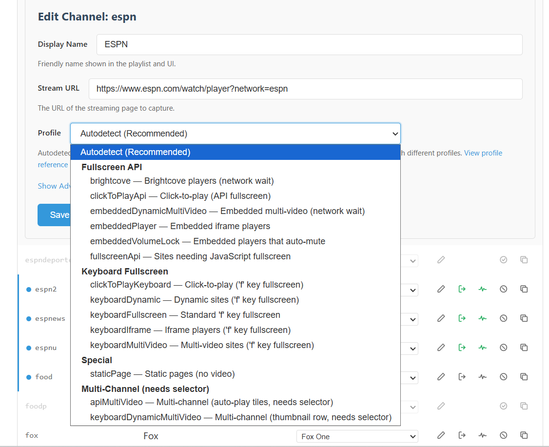

Do you know what profile PrismCast uses when you tune the ESPN linear channel using another method? We may need to force that same profile by adding &profile= to the tuning URL.
Set to audodetect, so not sure which one it's using.
Check in the log to see if it shows which profile is actually used for ESPN from a source that's working for you.
[2026/08/16 09:05:07.130 PM] [espn-v6lufz] Streaming ESPN: ESPN.com, keyboardMultiVideo, FFmpeg [H264]. Tuned in 7.1s.
