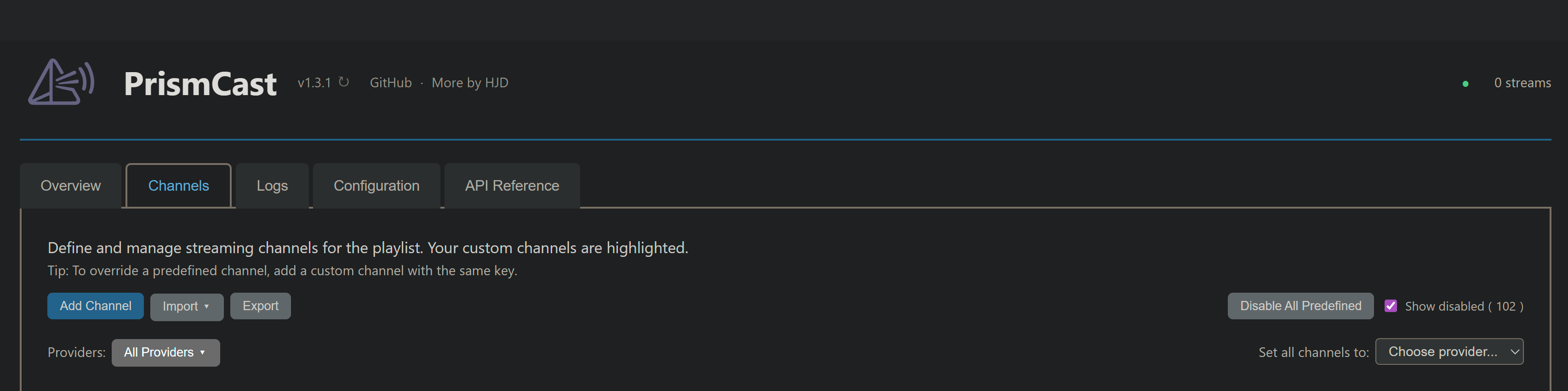

I'm going to guess that you have filtered providers in the Channels tab? Guessing YTTV and Sling, given our other exchanges? If you clear that out to the defaults showing all the providers, and add the NBC override in again, it should work. It's an edge case I missed in implementing the new provider filtering capabilities I suspect.

No provider filters. I did experiment with them at one point, but removed those filters almost immediately.
OK, I fixed it by just changing the drop down from YouTube TV to Custom (youtube.com)
I obviously don't know what I'm doing (or couldn't find those instructions)!
Enjoy. Teach others...pay it forward. :smile:
Once you create the override for NBC, ensure you select that custom channel for that entry explicitly. In the next release, this edge case is caught and automatically dealt with, but for now...that's what I would advise.
