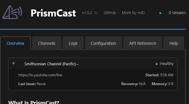

Is this supposed to be displaying only current streams?
Screenshot 2026-03-06 at 14-25-13 PrismCast
Reason I'm asking is that stream ended over an hour ago. Even refreshed the browser page.
[2026/03/06 05:59:02.710] [smithsonianp-0o96it] Streaming Smithsonian Channel (Pacific) (youtubeTV, FFmpeg). Tuned in 2.7s (direct).
[2026/03/06 13:01:44.209] [smithsonianp-0o96it] Stream ended after 7h 2m.
[2026/03/06 13:06:54.089] Restarting browser for scheduled maintenance (uptime: 9h 31m).
[2026/03/06 13:06:54.770] Chrome ready: Chrome/145.0.7632.160.
[2026/03/06 13:06:54.975] Browser restart complete. Fresh instance is ready.
[2026/03/06 13:06:59.771] Starting channel lineup precaching for 1 provider.
[2026/03/06 13:07:03.430] Precached YouTube TV: 139 channels (3.7s).
[2026/03/06 13:07:03.711] Channel lineup precaching complete: 1 provider cached in 3.9s.
And tried another browser.
Appreciated. This was super helpful in letting me track down this bug. Will be fixed in the next release. Thanks!

If you look at the top right, it shows 0 streams. You might need to clear the cache or similar...but it always only displays active streams. Or should. :smile:
OK, looks the same opening the page in another browser, so I assume it's some PrismCast cache you're talking about?

Nope, now that's on me to see if there's something going on. Stay tuned. Thanks for raising it.
