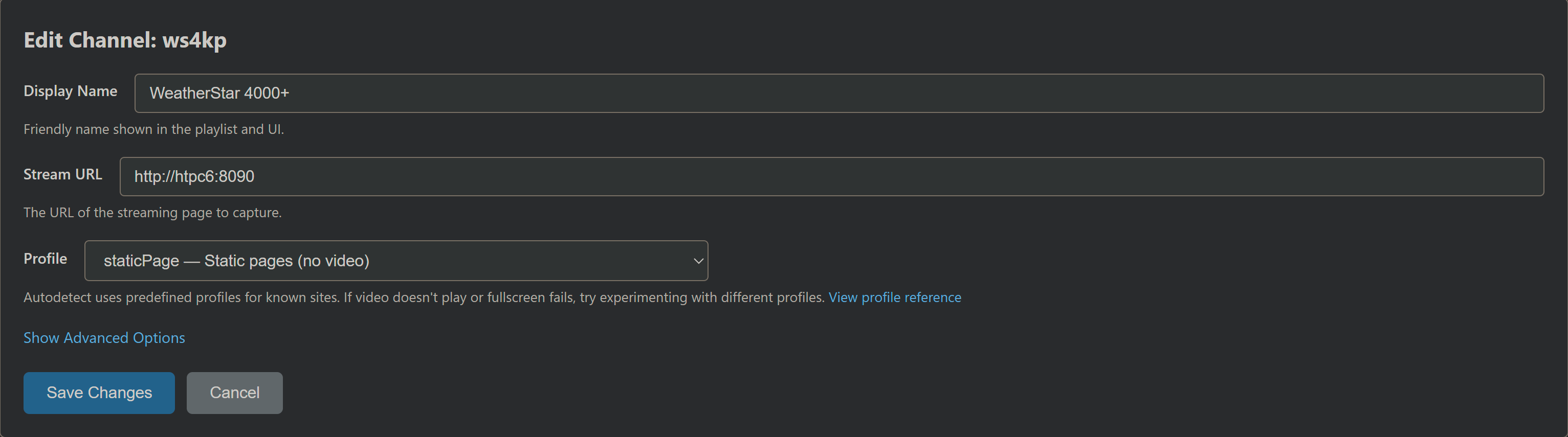

Has anyone been able to stream WeatherStar 4000 with PrismCast. I’ve been using CC4C. My goal is to move all over to PrismCast which has a better interface.

Pretty much the same as doing it with cc4c.
PrismCast custom channel:
Then the "login" step is basically just to tell ws4kp where you are:
  • Goto PrismCast's Chrome
  • Open a new tab
  • Navigate to your local ws4kp URL
  • Remove the &settings-kiosk-checkbox=true from the redirect URL to expose settings
  • Set your location, music or whatever
From that point, whenever you stream that channel, it'll show the weather for the location you set.

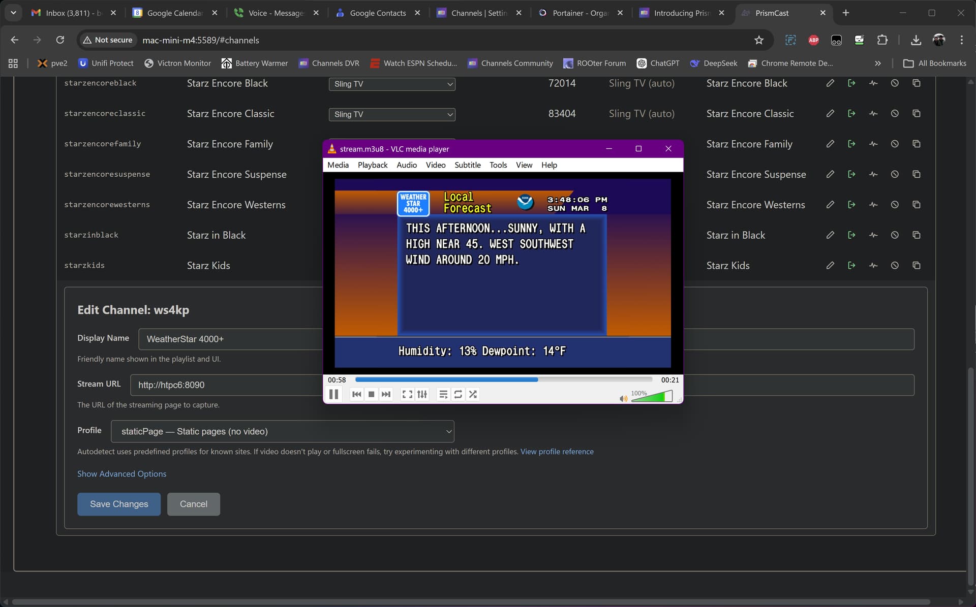

Moments after setting it up :slight_smile: :
Just in case you didn't use Project One-Click to set up your ws4kp stack, it should look like this:

Added this and it appears in PrismCast as added. I can hit the authenticate icon and it launches in Chrome as expected. It doesn’t show up as a channel in CDVR. I added Wearherscan and it worked as expected. Otherwise PrismCast rocks!

Did some digging. If left in automatic, it appears in Channels but throws a transcoder error and won’t play. If you edit to “static” it plays until the channel disappears from PrismCast and Channels. It will stay in Channels for several hours after doing the edit.
Hope this is helpful.
