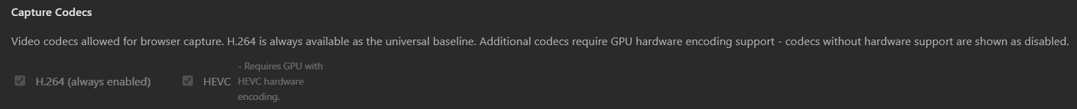

Our current Docker implementation, which uses a custom version of the virtual display server Xvfb, does not support hardware encoding (decoding only). In older versions of PrismCast, it wouldn't have mattered if it did. However, with this new HEVC option, it'd be nice to get it enabled. Not sure if it's possible, but I'll play around with it when I get a chance.
If you'd like to confirm what I'm saying, open a new tab in PrismCast's Chrome, and navigate to chrome://gpu.

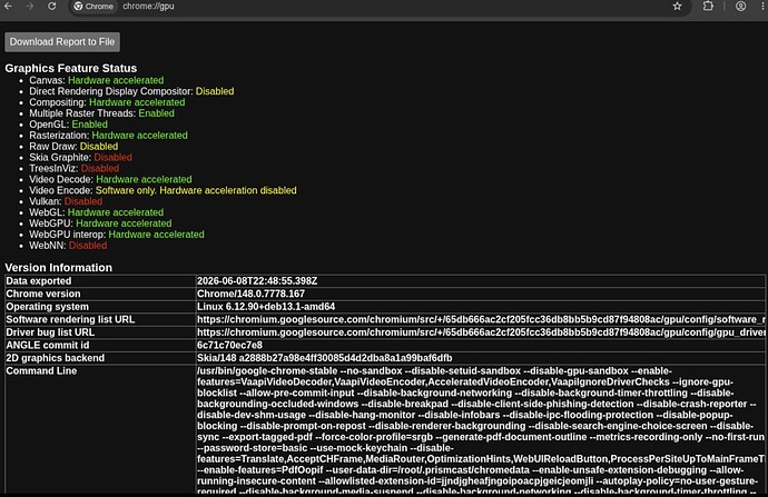

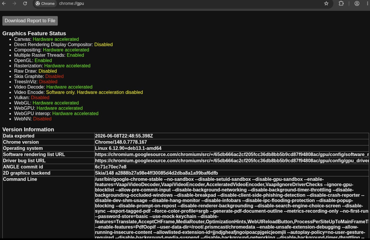

I actually looked at that chrome://gpu earlier.
So, as you can see, Video Encode is Software only. Whether we can do anything about that in the Docker world is unknown at this point. It was only a fairly recent development to have all the Hardware acceleration we do have working, and that's the result of the custom Xvfb build.
So your saying if I want that working I would need to dump Docker and run native with the npm install? Would I run into an issue with setting the resolution with no gui or monitor setup. Sorry very green with a lot of this.
Edit post. I see you said you might see if you can get it to work in the docker. I really do appreciate the hard work you guys did on this project.
I'm not sure I am saying that. But it would be interesting to know if that would work -- if you're willing to experiment.
I'd suggest starting with installing Chrome directly on your Debian system, and see what chrome://gpu reports. Linux Chrome doesn't get the attention from Google that the Windows and MacOS versions do, so just because something works under those OS's doesn't mean it'll work with the Linux version.
If you can't get chrome://gpu to "light up the board", there's little point in moving on to a PrismCast install.

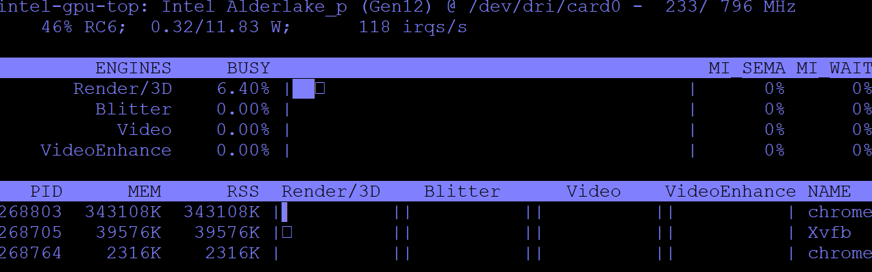

You over looked this in your docker run statement --device /dev/dri:/dev/dri
https://github.com/hjdhjd/prismcast#gpu-acceleration
are you talking about the LIBVA_DRIVER_NAME? By default it has iHD.
No, I'm talking about your docker run statement not passing thru the GPU device like it says
If your host has an Intel GPU with Quick Sync Video support, pass the GPU device to the container:

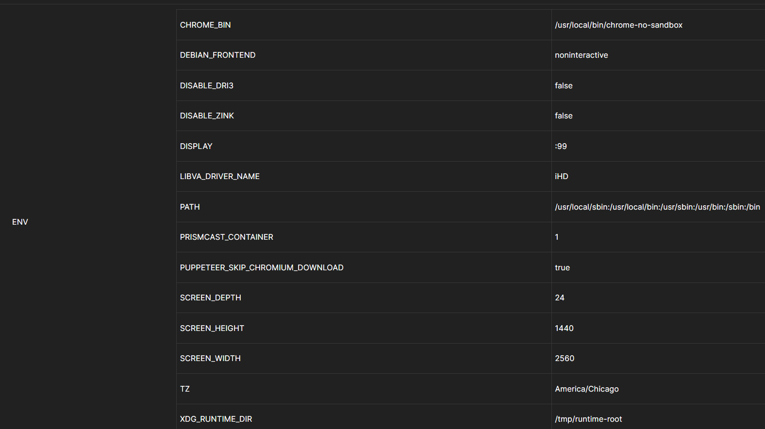

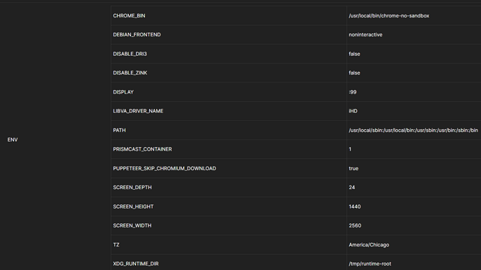

Here is what I actually used to spin it up.
docker run -d \
  --name prismcast \
  --shm-size=4g \
  --device /dev/dri:/dev/dri \
  -p 5589:5589 -p 5900:5900 -p 6080:6080 -p 5004:5004 \
  -v prismcast-data:/root/.prismcast \
  -e SCREEN_WIDTH=2560 -e SCREEN_HEIGHT=1440 -e SCREEN_DEPTH=24 -e TZ=America/Chicago \
  ghcr.io/hjdhjd/prismcast:latest
OK, I give up. That's not what you originally posted.
Like I said with the device /dev/dri:/dev/dri statement. The GPU actually does most of the work and runs at 8 percent. If I remove it. Then the processor jumps to 33%. So the GPU does seem to work using the container.
Yup my fault. That was in reference to the container website and the location of the files.
I went back and edited with what I actually used.
It is working -- for decoding.

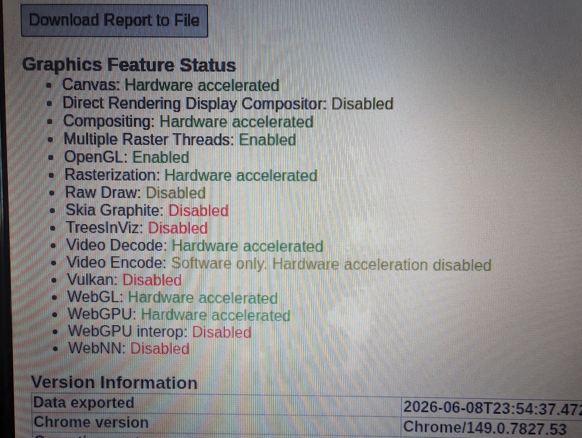

I happen to have an old laptop running Debian 13 Desktop and Chrome, and the report is the same:
Keep in mind here, I'm only talking about the issue you raised with why HEVC encoding is grayed-out.

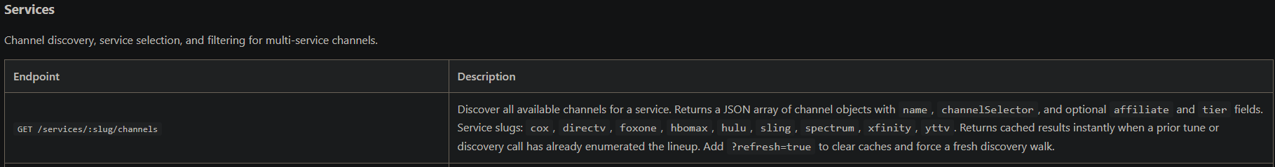

If you don't see Adult Swim in the channel selector dropdown
Force it to rescan the YTTV channels using the API
http://192.168.1.9:5589/services/yttv/channels?refresh=true
