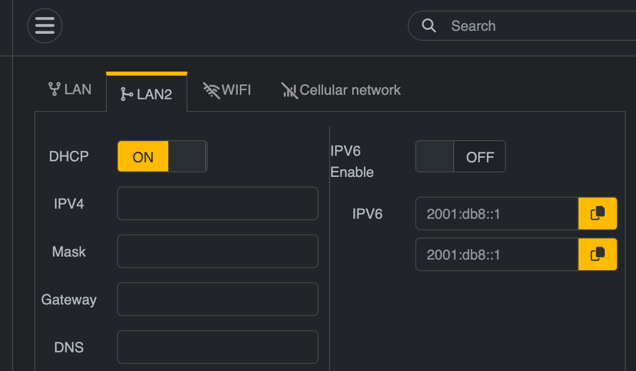

Another observation, sometimes when rebooting the enc5 via the web interface, in addition to one of the HDMI inputs dropping off, the device seems to believe that it has a second network interface.
Sometimes when it's in this state, the network connection repeatedly drops out every 30 seconds (exactly). Like the HDMI dropout, the only thing that fixes this is power cycling the device.

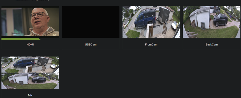

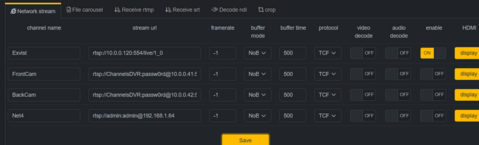

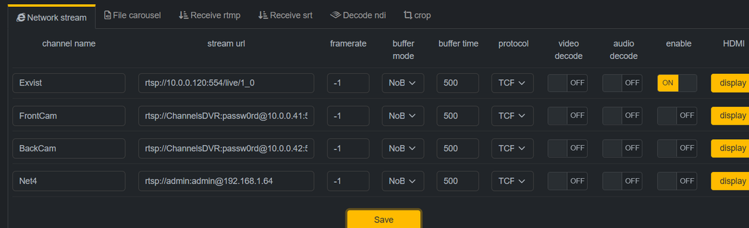

I figured out how to make use of my old exvist encoder. it seems to only show a smooth picture via rtsp, but I could not get any cdvr/extensions to actually load the rtsp, it just rolled over to the exvist's inferior http or wouldn't load. just let the linkpi translate under the decode tab. it does not need to be decoded/re-encoded, the linkpi just translates rtsp://10.0.0.120:554/live/1_0 to http://10.0.0.121/live/stream2
I can get my camera's rtsp feed directly into cdvr, however I'm trying to recreate this into channels
I can get the mix and everything to show on the dashboard, but I can't seem to load the mix even in vlc.
anyone else use the mix feature?

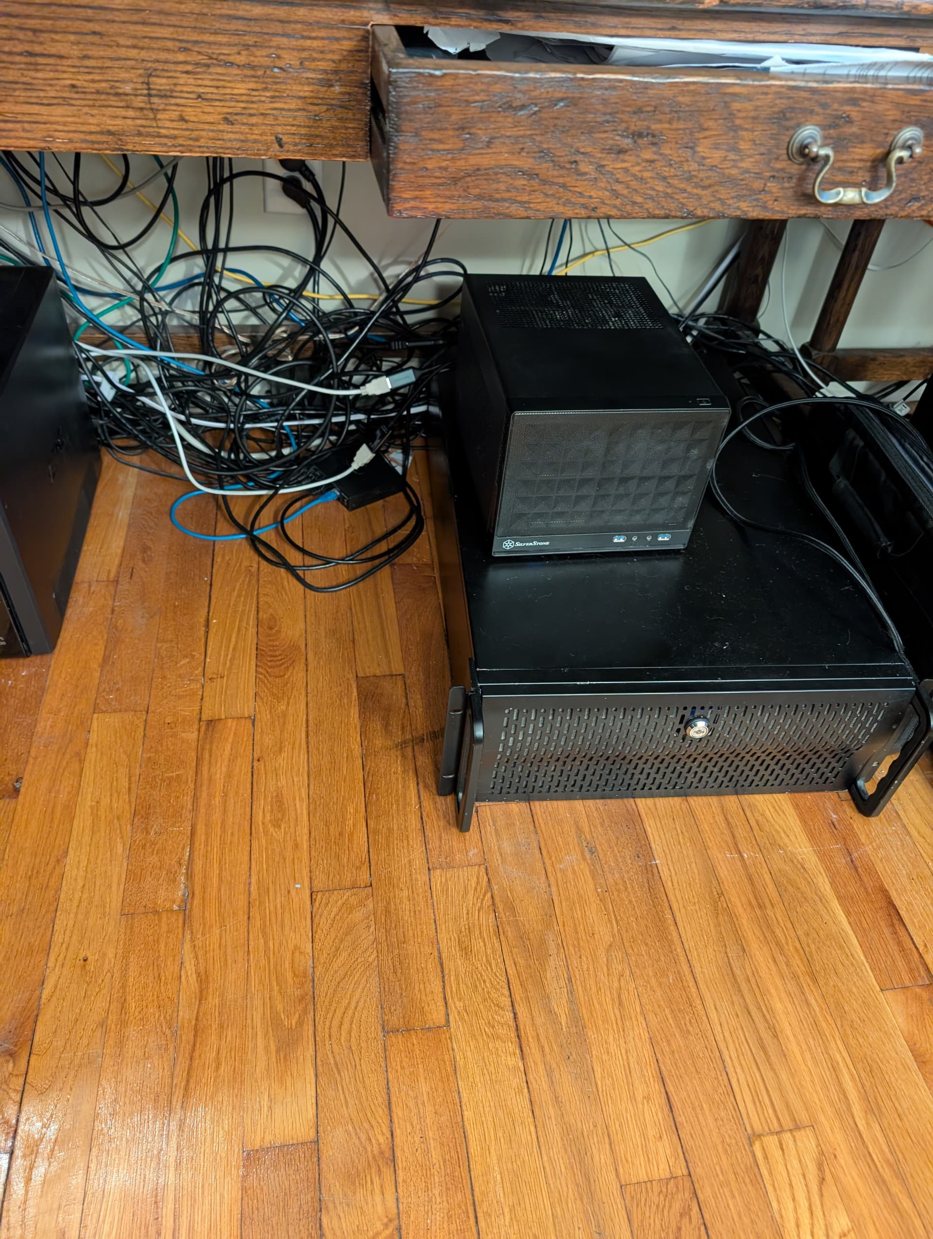

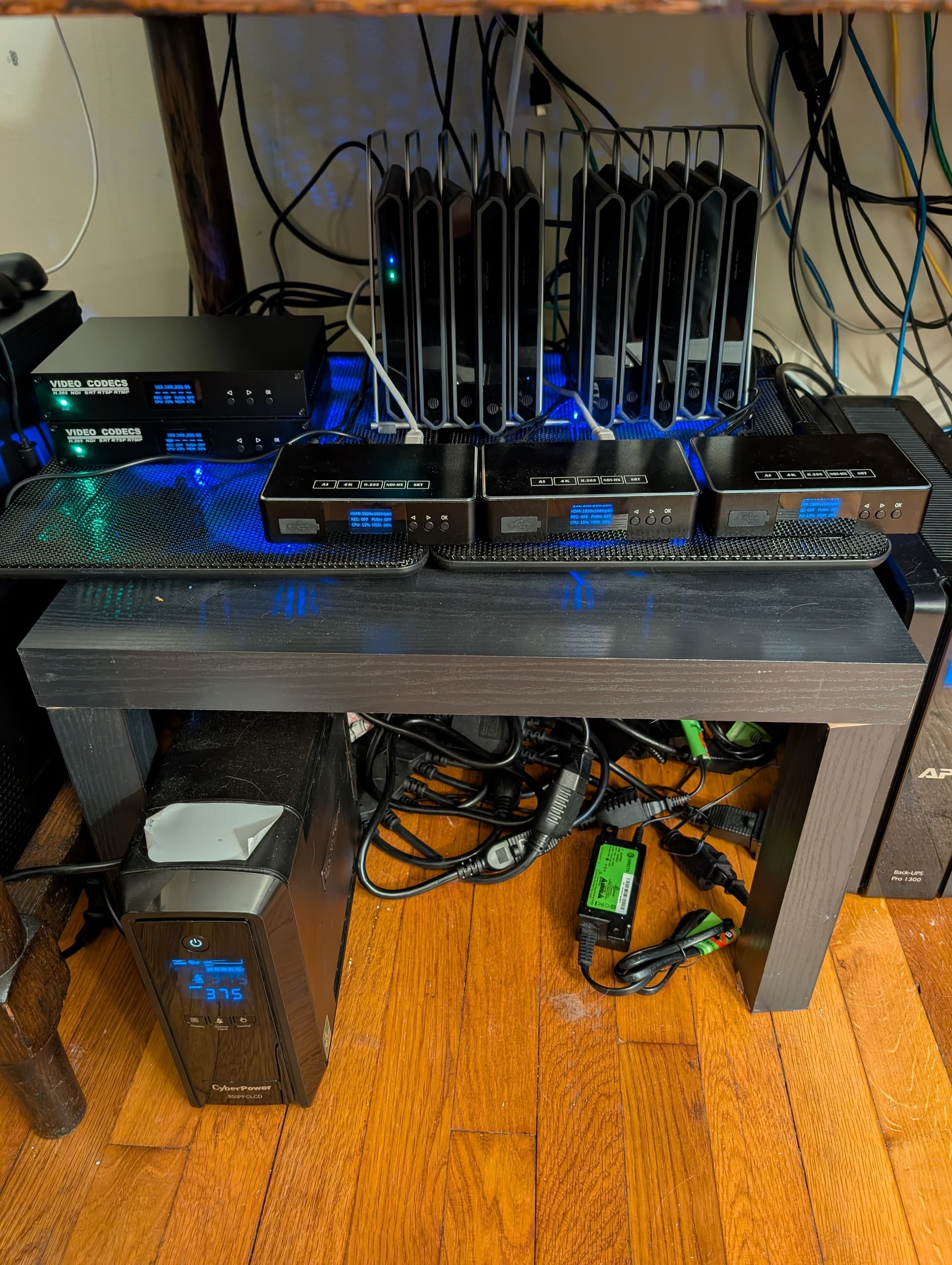

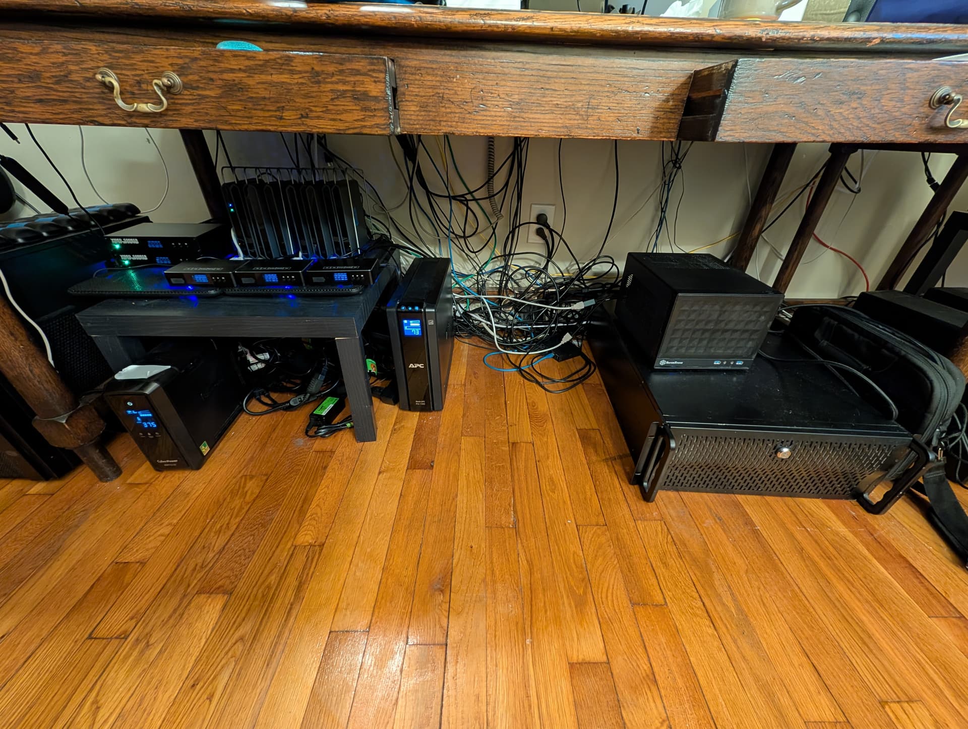

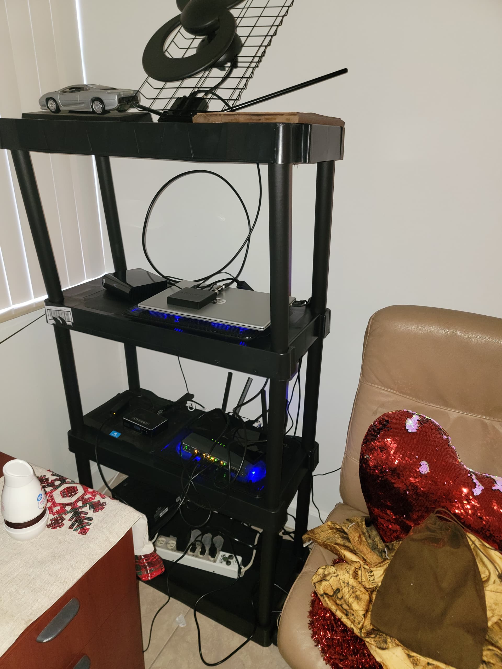

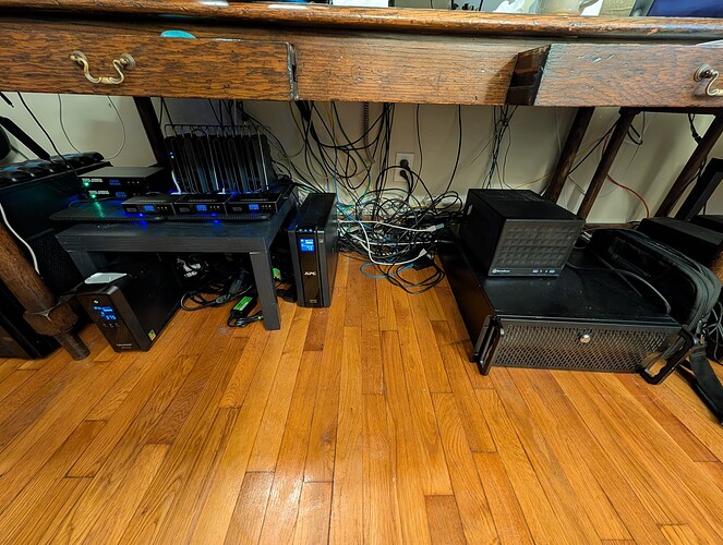

Bruh, you make my setup look puny. :rofl::joy:
And I just got some PoEs too so...yeah. It was more messy than this but still

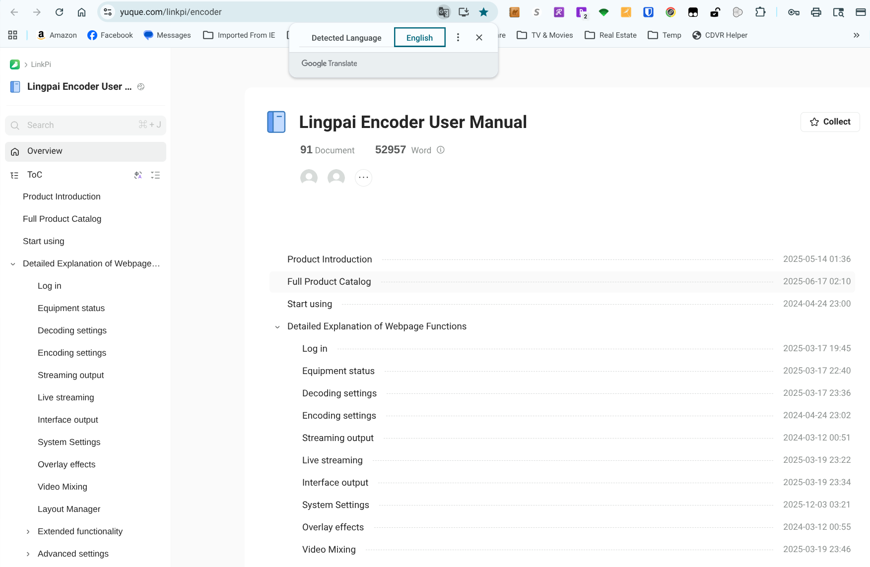

The Google Translate function built into the Chrome Browser does a pretty good job:
