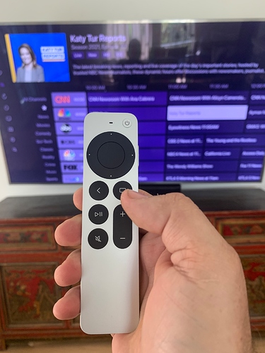

Delivery #1 just arrived, I have paired a new Siri remote to my living room AppleTV 4K.
Working well with Channels, feels great in the hand
