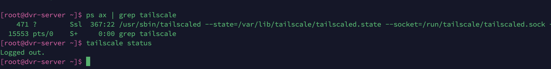

Cool command - ./tailscale status --web --listen 0.0.0.0:8384 but when I run it on my channel server (pi based) - I see nothing..
It seems like tailscale is running but a separate instance that support the dvr server.. If I run tailscale status it says logged out...
Yes tailscale is running - accessible and all that...
How do I enable tailscale web access for the instance that is supporting the channels server?
You can see yourself in the screenshot
I can't speak for the channel server tailscale implementation as I run the web server on my Unraid server's tailscale docker instance. Perhaps that feature is not enabled in the channel version?
