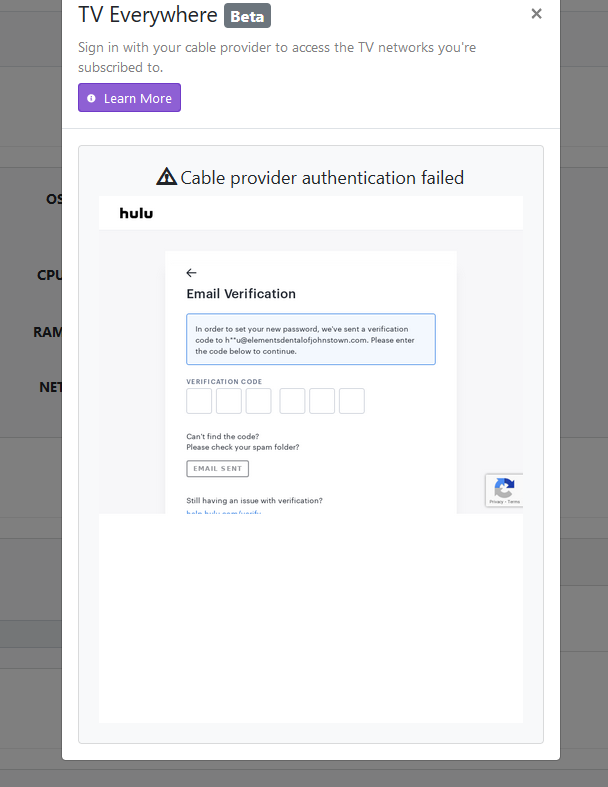

Well, I could not get Hulu Live to add back as a source. Channels pops a box up saying it needs a verification code (see pic) - but you can't type anything in it - I did an email with the code from Hulu...
I was able to Hulu to add back as source by deleting the device from Hulu - then it added back fine - except no NFL channel
