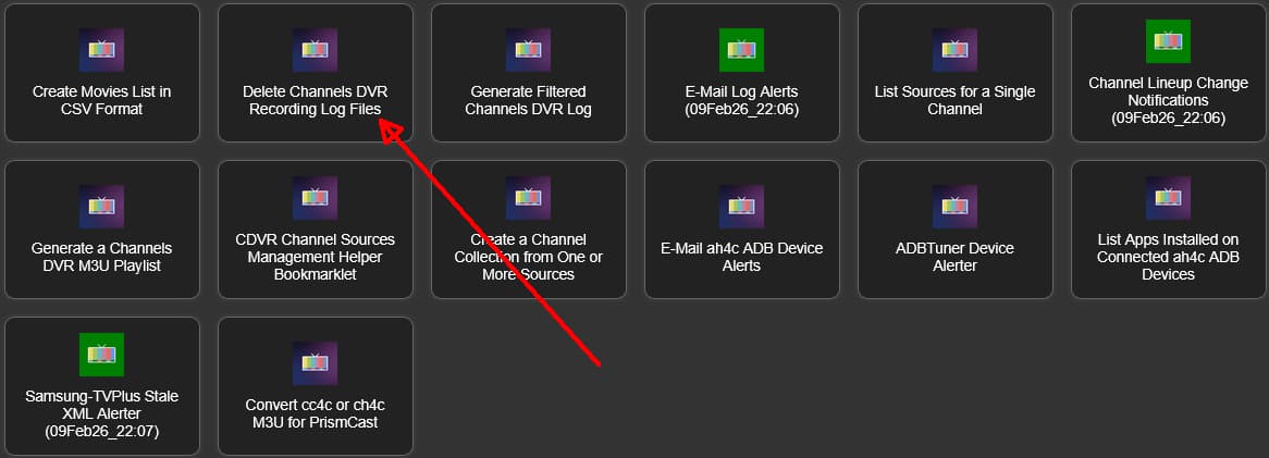

Anyway, I updated from 2026.02.02 to 2026.02.09 and my Delete Channels DVR Recording Log Files actions which were running before the update is no longer green. Refreshed browser many times.
I checked the log files and it appears the actions are running and the logs were replaced when I updated, but shouldn't have been (I have PERSISTENT_LOGS=true).
192.168.1.4-8489_deletelogs_latest.log
Background script initiated, with 1d between runs for 192.168.1.4:8489
Deleting recording log files for 192.168.1.4:8489 that are more than 1 days old
find: '/mnt/192.168.1.4-8489/Logs/recording/*': Deleted
Background deletelogs process running for 192.168.1.4:8489

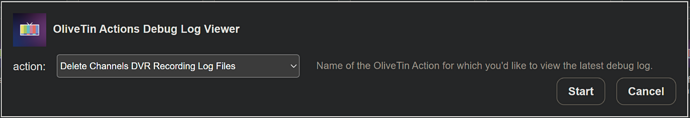

Could you post the output from the OliveTin Actions Debug Log Viewer for this Action?:
EDIT: Also, from your OliveTin config directory (on the host, or exec'd into the container), could you post the results of this (redact your healthchecks.io UUIDs if you're using them):

root@olivetin:/config# cat *deletelogs.running
192.168.1.4:8089 deletelogs 1d https://hc-ping.com/your_custom_uuid
192.168.1.4:8090 deletelogs 1d https://hc-ping.com/your_custom_uuid
192.168.1.4:8189 deletelogs 1d https://hc-ping.com/your_custom_uuid
192.168.1.4:8190 deletelogs 1d https://hc-ping.com/your_custom_uuid
192.168.1.4:8289 deletelogs 1d https://hc-ping.com/your_custom_uuid
192.168.1.4:8389 deletelogs 1d https://hc-ping.com/your_custom_uuid
192.168.1.4:8489 deletelogs 1d https://hc-ping.com/your_custom_uuid
