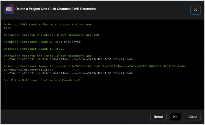

OK, so could you run the Project One-Click Delete Action for mlbserver, which should look like this in the results window (post if it doesn't):
Then stop the OliveTin-for-Channels stack, and update it (I just pushed a small change that may help).
Then re-run the mlbserver Action, and make sure to mind the "blue spinner" in the results window, as that indicates the Action isn't done running.
Post the full contents of the results window if it doesn't complete correctly. Copy-and-paste the full text rather than a partial screenshot...
Seemed to do the same thing still. It successfully deleted. I updated olivetin, ran the project one-click action again and it seems to hang at the "blue spinner". The stack was installed and the container is running, but I can't get to anything on that port.

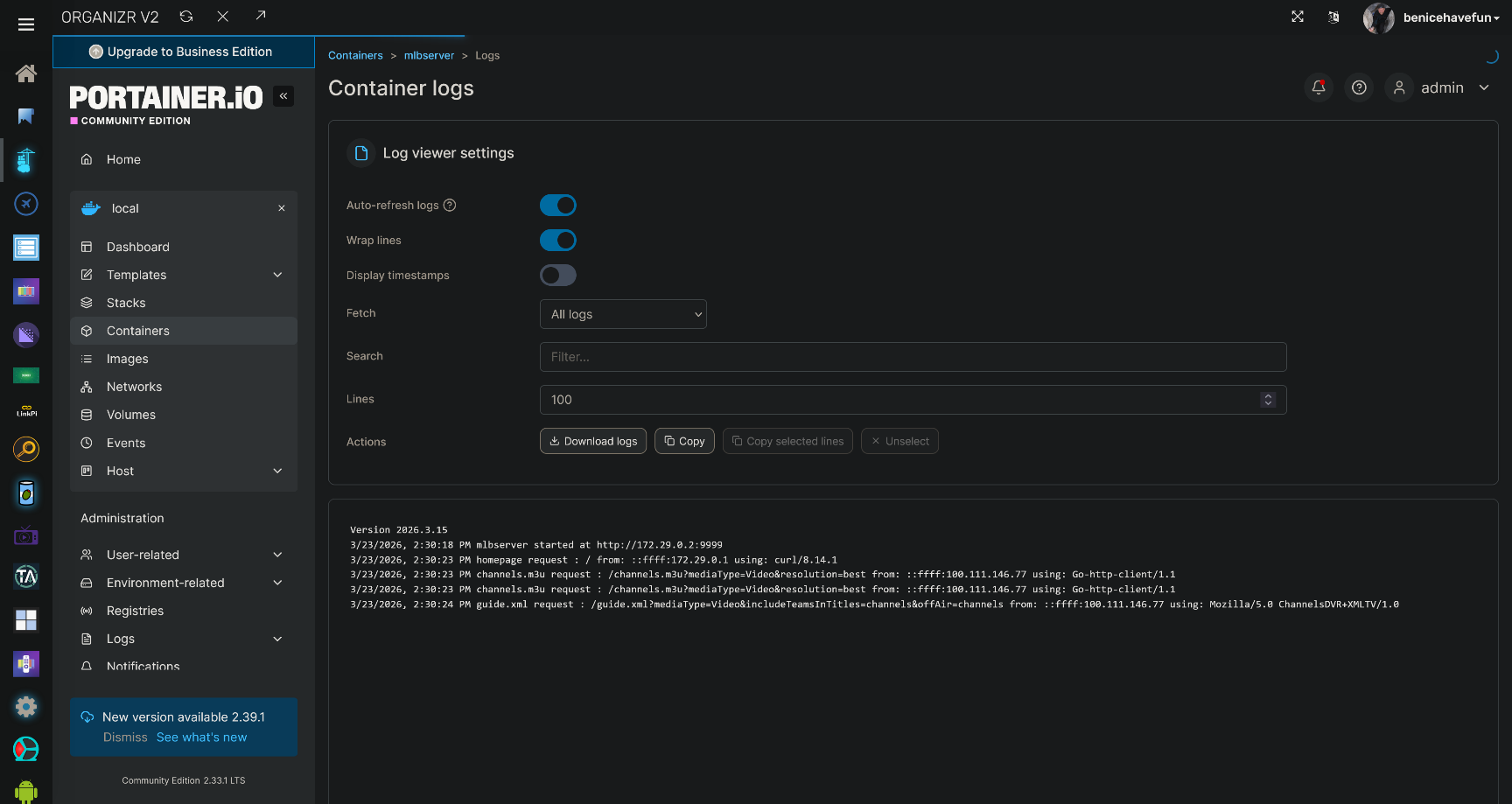

What do you see using the Portainer-Containers Quick Action button to view the logs?
It should look like this:

Version 2026.3.15
3/23/2026, 3:32:40 PM mlbserver started at http://172.22.0.2:9999

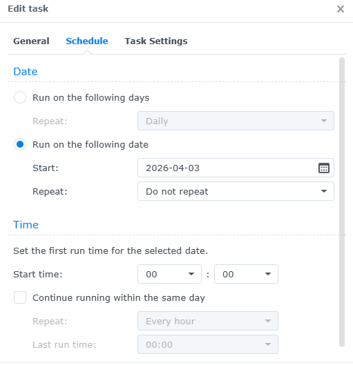

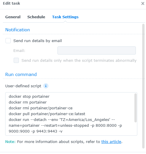

I created a user defined task in Task Scheduler that I manually run to update Portainer.
brave_screenshot
script
docker stop portainer
docker rm portainer
docker rmi portainer/portainer-ce
docker pull portainer/portainer-ce:latest
docker run --detach --env 'TZ=America/Los_Angeles' --name=portainer --restart=unless-stopped -p 8000:8000 -p 9000:9000 -p 9443:9443 -v /var/run/docker.sock:/var/run/docker.sock -v /volume1/docker/portainer:/data portainer/portainer-ce:latest

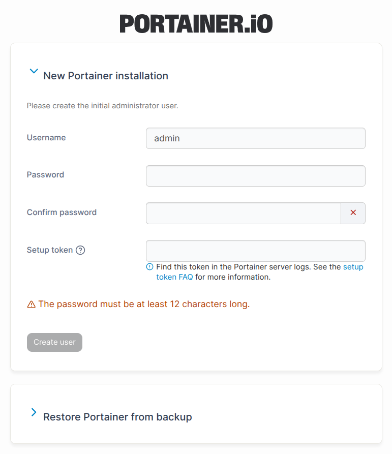

Uh, Oh. I think that may have broken my previous installation. Portainer now starts up looking like a fresh installation. 🫣 Fortunately, this is on my backup NAS, Secondary CDVR server.
