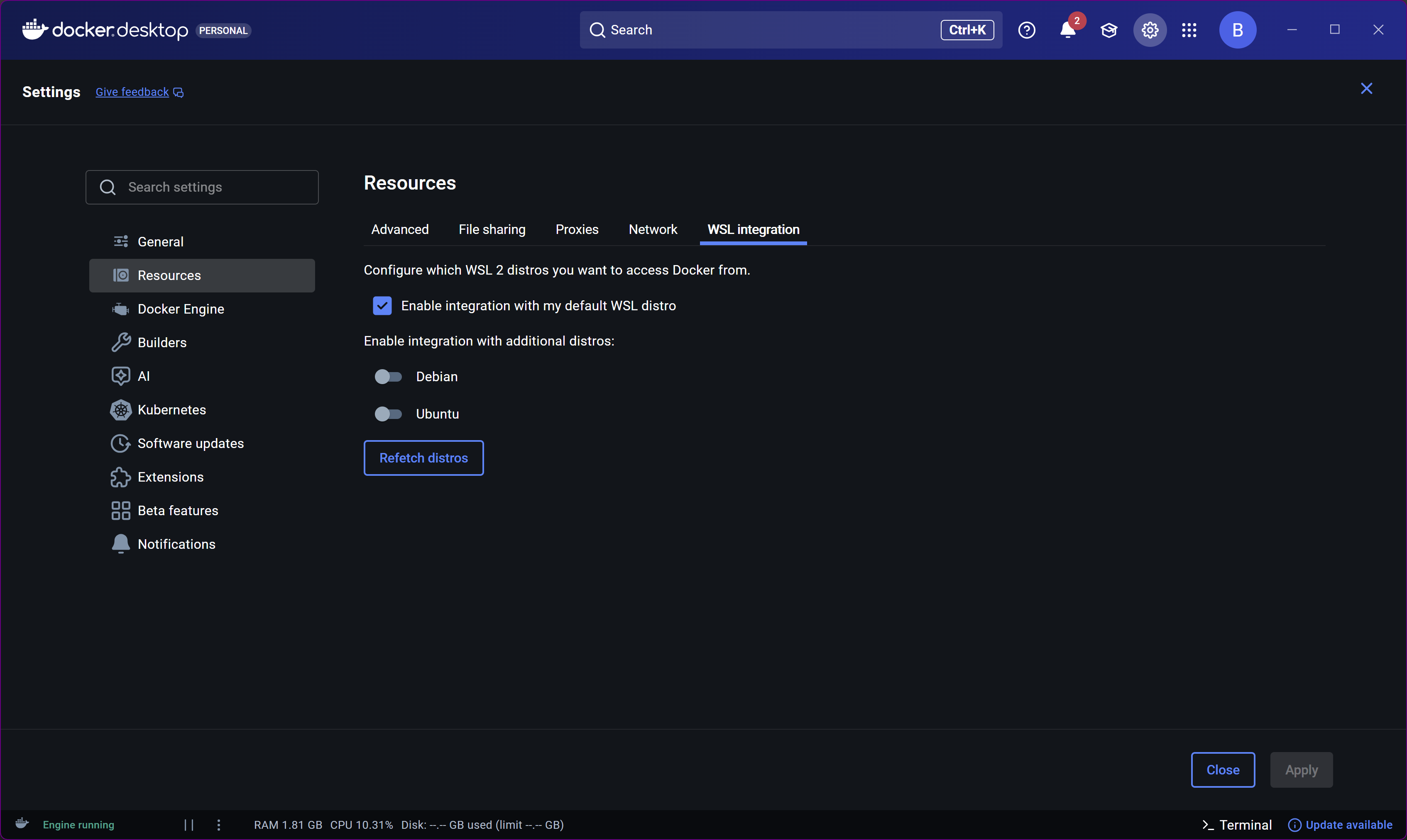

Make sure you have a WSL2 Linux distro installed (I recommend Debian), which is something you can get from the Microsoft Store. Use your same Windows username and password (if possible), when prompted during Debian setup.
Finally in Docker Desktop, confirm "Integration" is enabled with your default distro:
