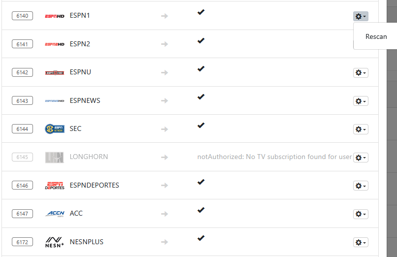

It seems that ESPN is missing from Fubo's TVE channels. I've rescanned Fubo in Channels and it's just not there.
Did you try rescanning just the ESPN channel you're missing?
Source > :gear: Manage > Rescan Channels
Does it give you a checkmark or error message?
That's step 12 (assuming you're good with steps 1-11) TVE Troubleshooting tips
