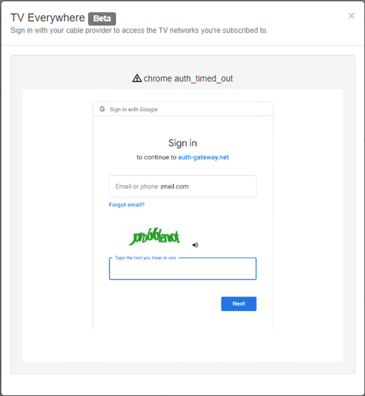

I am having troubles signing in. It appears there's a captcha that I need to fill out but there is no way to do it?
Any help would be appreciated.
I’d try logging into your google account from another device in the same location. The captcha is probably a one-time extra security step, so if you complete it on another device that may prevent it from appearing for Channels.
