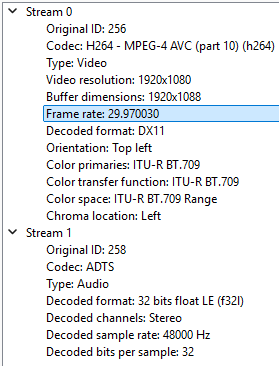

VLC thinks the framerate is 29.97 fps
VLC

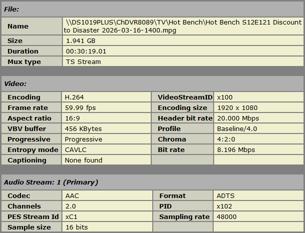

My Video editor thinks it's VFR (Variable Frame Rate) at 59.99 fps average
VRD

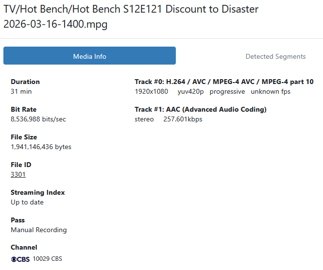

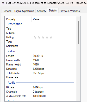

Windows 11 doesn't display a frame rate
Windows
Channels DVR doesn't display a frame rate

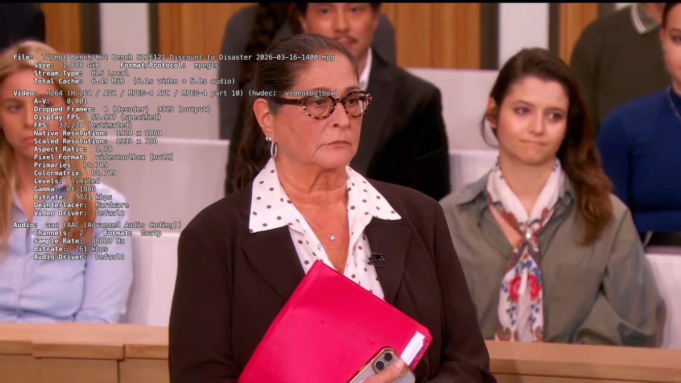

Downloaded the recording to my iPhone, turned Airplane mode on and am playing it.
It's dropping output frames and A-V and FPS are changing as it plays.

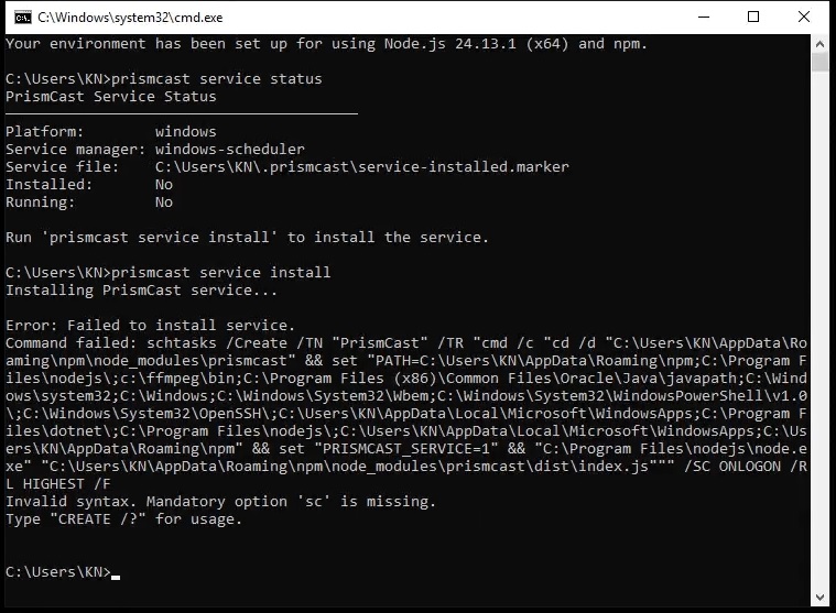

Still throwing an error when I attempt to install the service.
What is that error?
