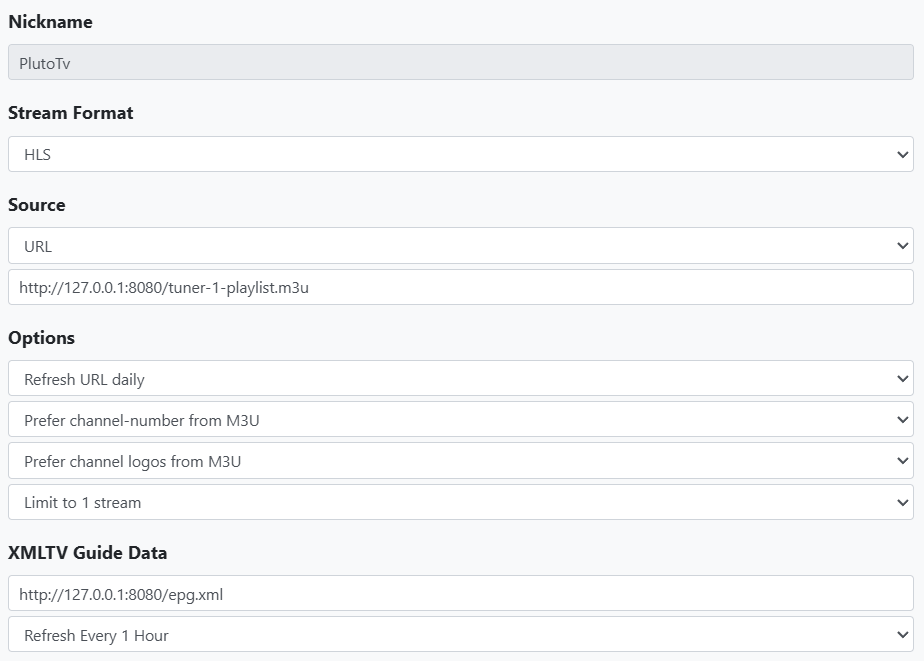

I find the @maddox solution quite a clever approach ... it basically let's Channels manager the streams as individual tuners. I tried it out with setting up 6 single channel sources and recorded 4 channels simultaneously...it worked great. The Pluto-for-Channels web screen is a nice touch.
It would be nice if it was handled similarly to HD Homerun (4 tuners), where we could just indicate the number of tuners/streams at 12 (or whatever) and the proxy would manage the tuners/streams...that would allow a single channel lineup. The interface to manager the tuners is already built into Channels, so it seems like the new proxy just needs to leverage that type of API to the proxy.

Creating multiple sources with the same channel list doesn't replicate the channels...so you don't need to create separate groups of channels for each source. Channels just sees all the sources as a pool from which to draw and will manage opening a stream in whichever source is available. In summary, you don't need to edit the 400 channels... just create multiple sources of the same list with a single stream each and let Channels do the management.
This approach works great, but it looks like it has been replaced with the newer KineticMan docker proxy which maintains 10 (default) rotating streams so you don't need to create multiple sources. I haven't tried it yet, but that sounds like a better path forward (much like my original request of making it look like HD Homerun). I'd recommend checking that solution out... and if it doesn't work for you, you can always go back to the multiple source approach.
