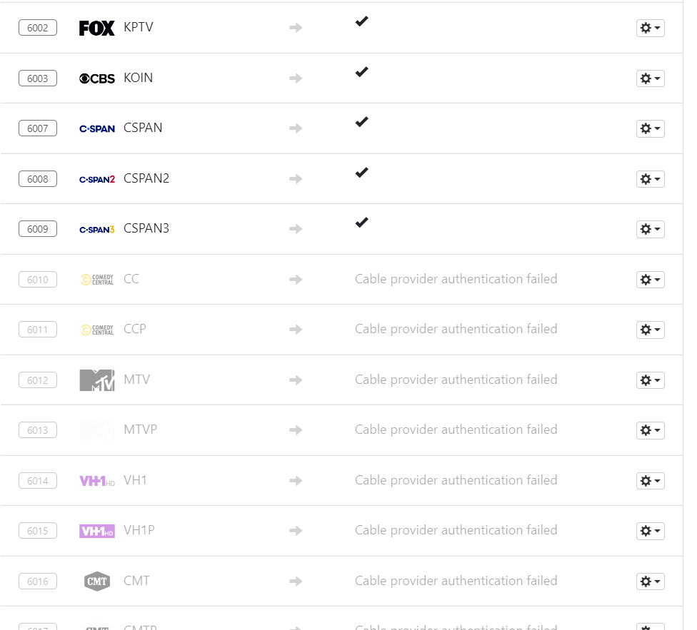

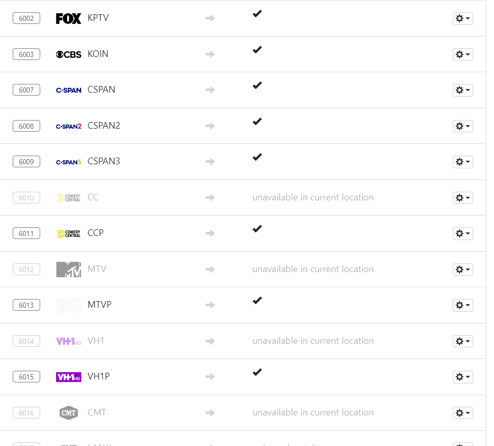

Why is TVE so terrible on the Synology takes a long time to scan and misses a lot of channels ... but on ubuntu Server TVE works great scans quickly and all Channels Authorize .. Is there a problem with TVE on Synology ?
Same user and PWD on Synology can only get 174 Channels on Ubuntu get 193
TVE Synology ....
TVE ubuntu

Check chrome is up to date on troubleshooting page
All looks good ...

I have an automatic scan that I run an hour before Primetime and everything authenticated. I now have 191 Channels on Synology and Ubuntu. That is why I never remove my XFINITY user a full scan usually fixes it if the problem is not one that requires a pre-release.
