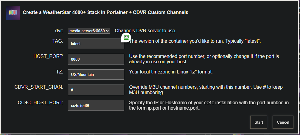

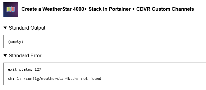

did i miss a step?
No -- that's a me problem. :frowning: I dropped the weatherstar4k files into the wrong build folder. I guess you're the first one to try it in production. I'll have a new version pushed shortly...
EDIT: It's built -- re-pull and redeploy and you should be good.
