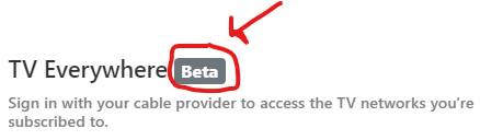

here is your answer, this is always the answer. that label always negates that it will always work. try another provider?
I've been using channels DVR for 7 years. The original port to synology was done on my hardware. I've worked directly with @tmm1 in the development and testing of TVE. I am well aware of its "beta" status and I'm not asking about that.
