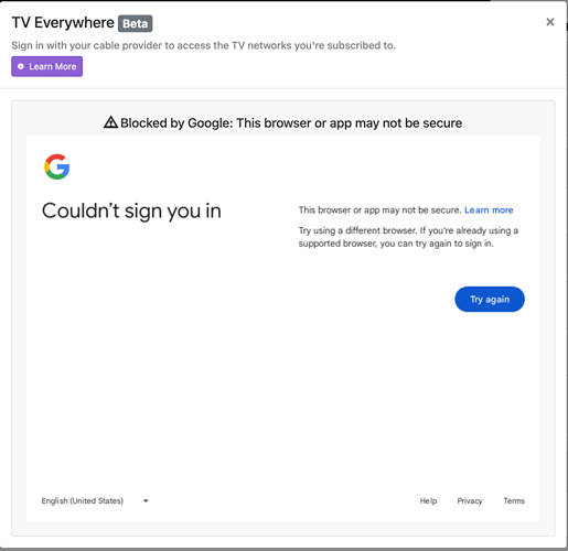

I updated to pre-release 2025.12.09.2002. I then did the Dish sign in, holding Sign In. It updated Chrome to 129.0.6668.59.
I then tried to sign in using the youtube TV login that is linked to the gmail that has no 2FA or anything tied to it......and I got the same error. I also posted this in the other thread so its not liking that Im posting the same stuff again. It keeps blocking my post.
