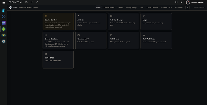

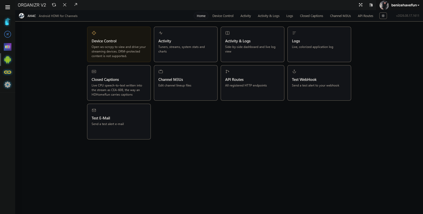

The main page can be found at the address you specified for $IPADDRESS:
And a few sample pages:
Activity & logs:
Edit Channel M3Us:

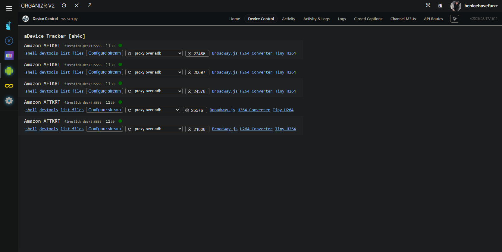

In addition a browser based version of scrcpy is also included, using a common adb authorization database with ah4c. Be aware, DRM is not supported with this tool though, so you'll see all the menus and can open apps, but none of the DRM protected content will display. Even with that limitation, it's amazingly useful, particularly for remote access and control of your sticks:
This can be found at the port you specified in your docker-compose (usually 7655). All of the streaming sticks defined in your docker-compose will be listed:
Click on shell, and you'll have an adb shell in a new tab where you can issue commands to your selected streaming stick. Back in the original tab, click on Configure stream, followed by:

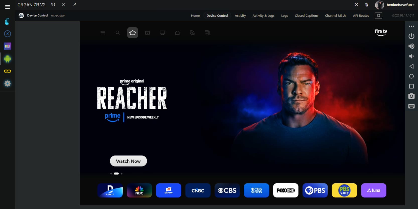

And you'll see whatever your HDMI-connected streaming stick is displaying:
There's a button to passthrough keyboard commands, along with Home, Back and Screenshot buttons. Any commands you can't generate on the keyboard you can send from the shell. Examples of these would be:
